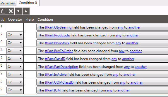

I have a DD to populate the Change Log for the Part Table. I have a condition block to monitor 9 fields.
  1. Is there a condition I could test for, for when the record is first created? And if so, could a Change Log entry be created? (I’m of the school that going from ‘Non-existing’ to ‘Existing’ is a change)
  2. Is there a better way to specify the fields to be monitored, or is individual criteria OR’d together (like shown above) the way to go.

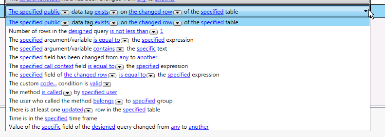

Is that a condition I can set in a DD Condition widget? If so which of these:
Or was that a method of a BO? If so, there is no ChangeLog widget in a BPM. I’d have to write custom code to add to that table, and I’d rather not.

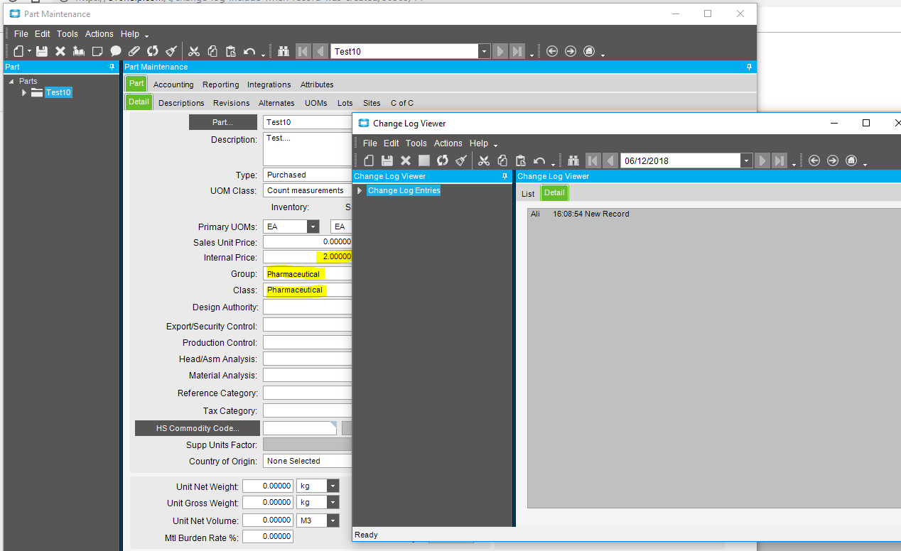

I think maybe just habit from 9.05. You HAD to have a condition in 905 dunno if you do anymore. The result is this in the change log

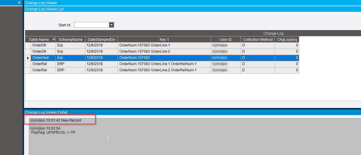

All our Change Log widgets come straight from the start block and we do get Added records in there, but something always changes at the same time so I was assuming that was the difference. It hadn’t occurred to me to put a condition in.

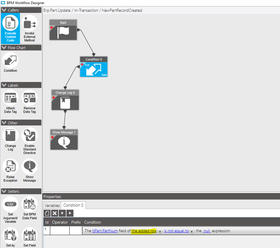

it can be done by both DD and MD, put let stick with DD as you trying to do:
i have just used the rowmod (Added) linked to any field -in this case PartNum-, to trigger my BPM as:

if you conditioen this DD BPM as i explained it should only add new part to ChangeLog,
i have done many changes to my part, and as you can see only one change added

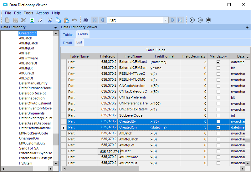

At least for Part, since 10.2.100 these are being populated (but not displayed):
The other fields, you’ll have to use @A.Baeisa’s solution.

Just curious… But when a field is added to a table, and it is mandatory (like CreatedOn), what value does that field get set to on records that pre-dated the addition of the field?
In this case, do they get set to the date the table was updated(when the new fields were added)? Or possible set to an obvious value like “01-01-1900” ?
Calvin,
Don’t know the answer to that but it does look like it has been tracking the creation date / User since at least 10.1.600.6. We went live Dec of last year on 10.1.600.6 and upgraded to 10.2.200.7 in July and have all the data from the migration parts created on 12/1 and creation dates on all new parts since then.
