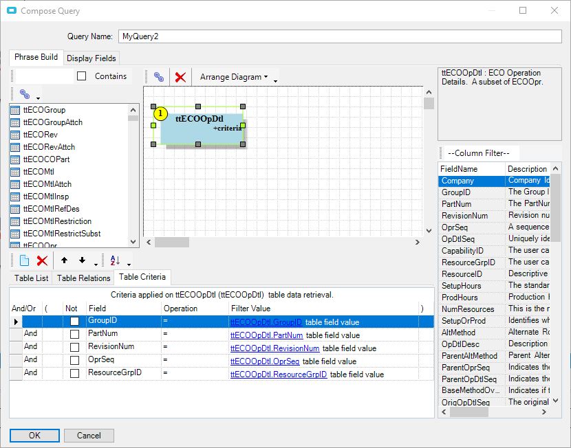

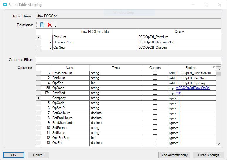

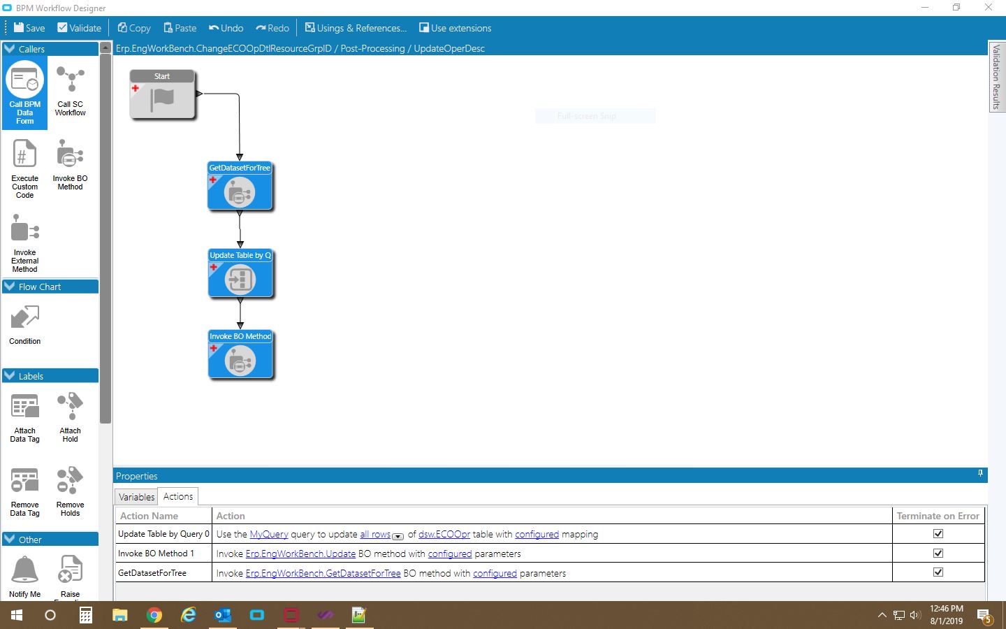

I am making a simple post-processing directive on the ChangeECOOpDtlResourceGrpID method of the EngWorkBench BO.
The goal is to pick up the new resource id group description (from ECOOpDtl.OpDtlDesc), and plop that value into the ECOOper.OpDesc field.
The directive below sort-of works. It updates the description for all operations for the specific part/rev. I tried changing the ‘all rows’ part to ‘updated’, and to ‘changed’. But, the only way I could get anything to update was to use the ‘all’ option.

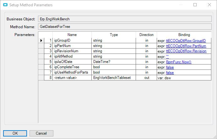

How do I just get the one row I want to update? Shouldn’t GetDatasetForTree, and the query mapping be enough to identify the row I am looking at?
