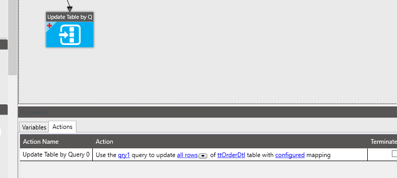

It can be done with no code - just using one Update Table by Query widget
The sample below copies the QuoteDtl.JobComment to the OrderDtl.OrderComment, whenever SalesOrder.GetByID fires
qry1:
Phrase Build
Display Fields
configured mapping

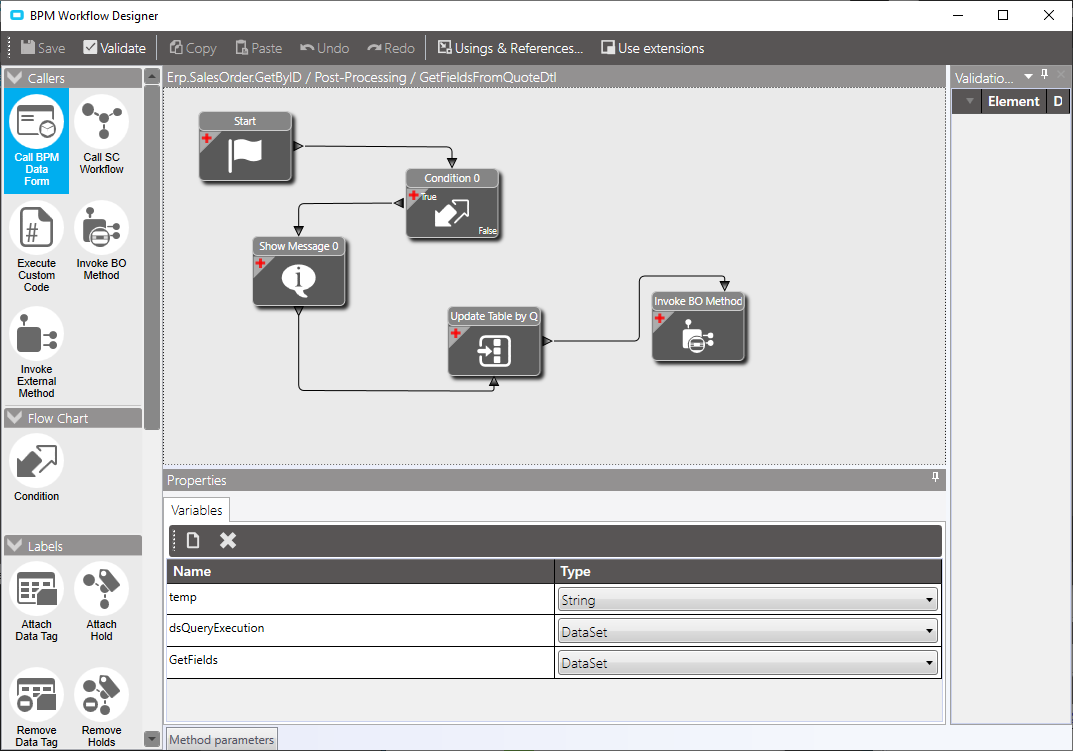

I tried to do what you wrote before (adding both H&L to the query and mapping) but it does not work :confused:.

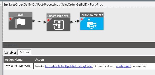

One more thing… You will actually need a second widget.
What I showed in Post #13 would make the Quote Info show in the Order Entry UI, but wouldn’t actually commit it, unless the order was saved in the UI. To make it autmatically save, add an Invoke BO Method widget to invoke an update method.
I added the BO Method but it’s the same

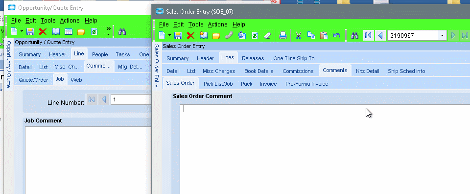

Here’s a GIF of it working for me.
  1. It shows me switching between two orders that were made from quotes, and that the Sales Order Comment is blank on both orders
  2. I then enter something in the Job Comment on the quote and save.
  3. I then go back to the Order Entry form, and upon loading an order (tied to that quote line), the Sales Order Comment is updated with the Job comments from the quote.
Not shown, is that if I disable the BPM, then change the quote job comment, the order lines retain their prior values.

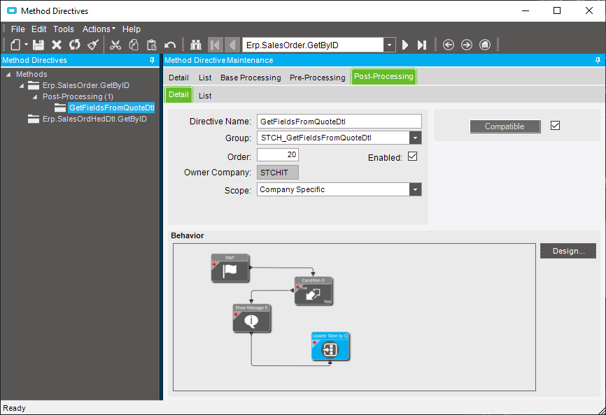

Today it worked. I don’t know why yesterday wasn’t working, I changed nothing.
Probably was another customization interfering.
Thanks for all your help!
I often forget to save the BPM when testing. :frowning:
The BPM isn’t truly updated after saving and closing the Designer window… You have to save the BPM itself too.
