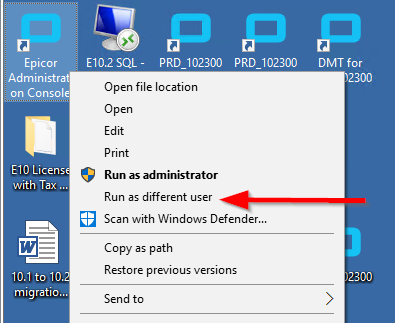

While logged into the App computer as ckrusen, I can connect to the app, on if I launch EAC as a different user (hold down SHIFT, and right click the EAC shortcut, and select “Run as a different user”)
I enter my credentials for my exas_ckrusen domain user and then EAC is running like user exas_ckrusen was logged into the computer. Then when I select our Production App, it connects with no problem.
