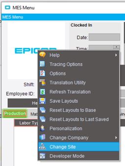

How does one change plant in MES. Bringing up the menu from the upper left corner and using ‘Change Site’ does not work.

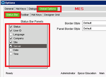

Also - if you haven’t already done so, I set the “Global Options” in MES so it is easy to verify account/company/site

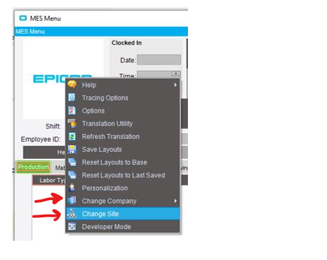

Is the site in a different Company? If so, first click on “Change Company” and then “Change Site”.
