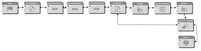

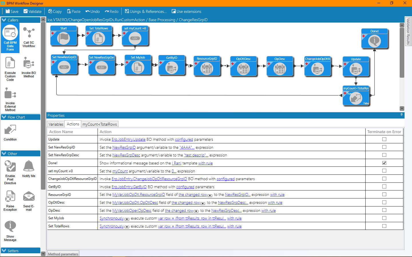

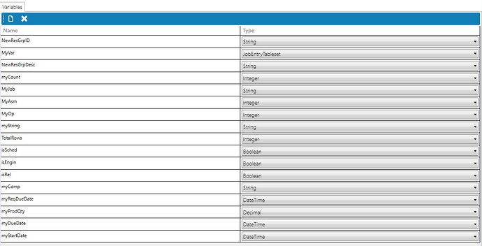

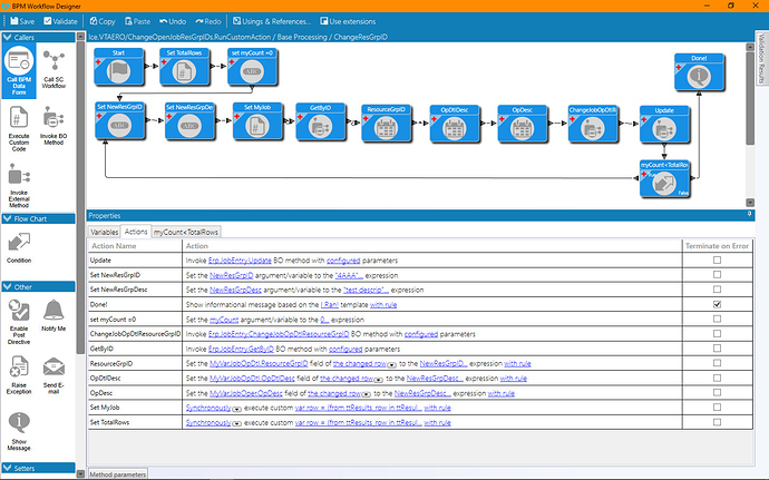

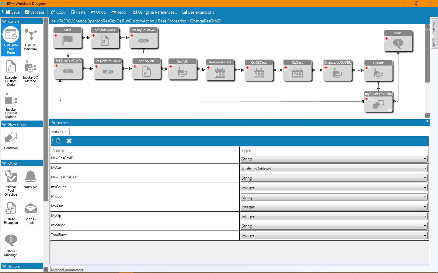

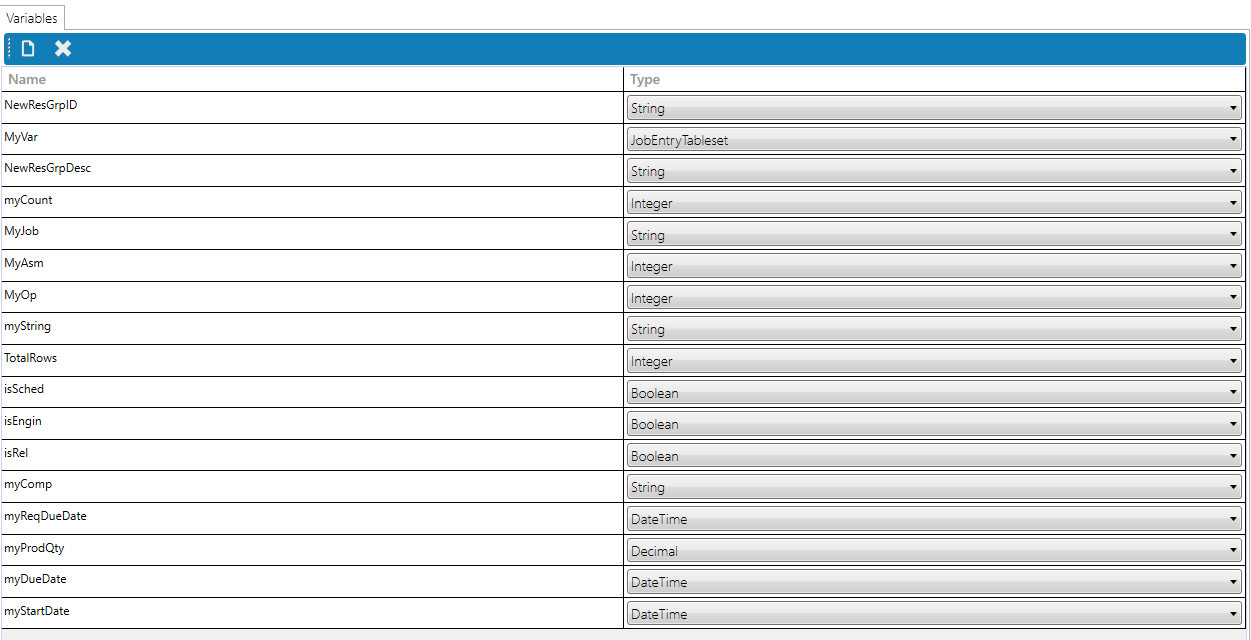

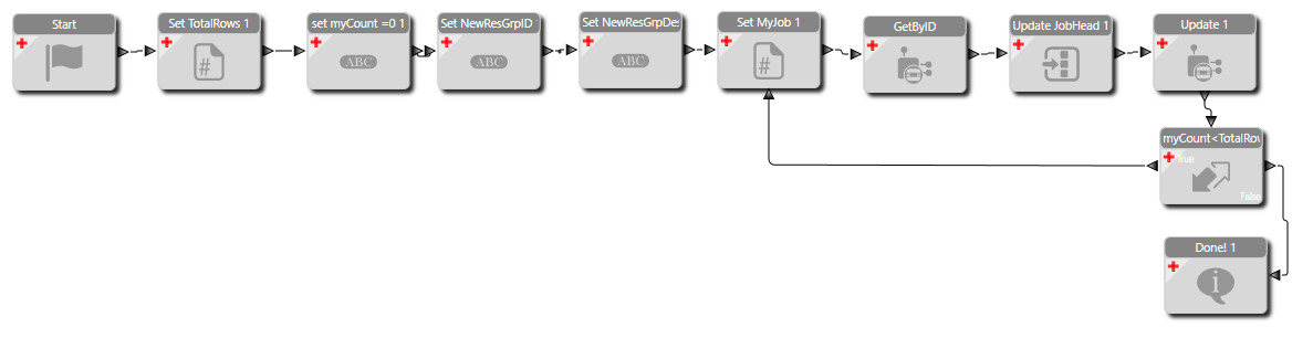

My BPM may look a bit convoluted. I have to loop through each of the rows in my results query. Here is my BPM outline and variables:
And the action details:
The code I placed in the custom code widget ‘Set TotalRows’:
var row = (from ttResults_row in ttResults where ttResults_row.Calculated_Processed == false select ttResults_row);
TotalRows = row.Count();
The code I placed in the custom code widget ‘Set MyJob’:
var row = (from ttResults_row in ttResults where ttResults_row.Calculated_Processed == false select ttResults_row).FirstOrDefault();
    myCount = myCount + 1;
    MyJob = row.JobHead_JobNum;
    MyAsm = row.JobAsmbl_AssemblySeq;
    MyOp = row.JobOper_OprSeq;
    row.Calculated_Processed = true;
I think this will be a regular task for a while as we update our internal systems to match the shop floor. However, I expect once the update is done we won’t be changing this kind of thing regularly. Maybe i’m making a mountain from a molehill, but its the journey not the destination. Right? :slight_smile:

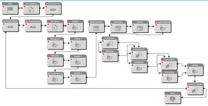

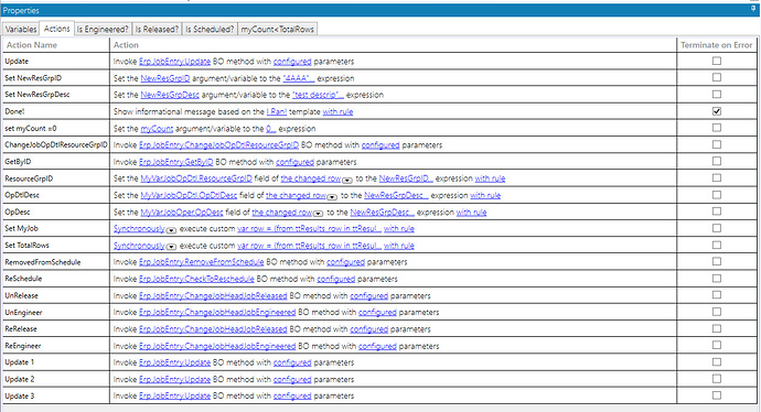

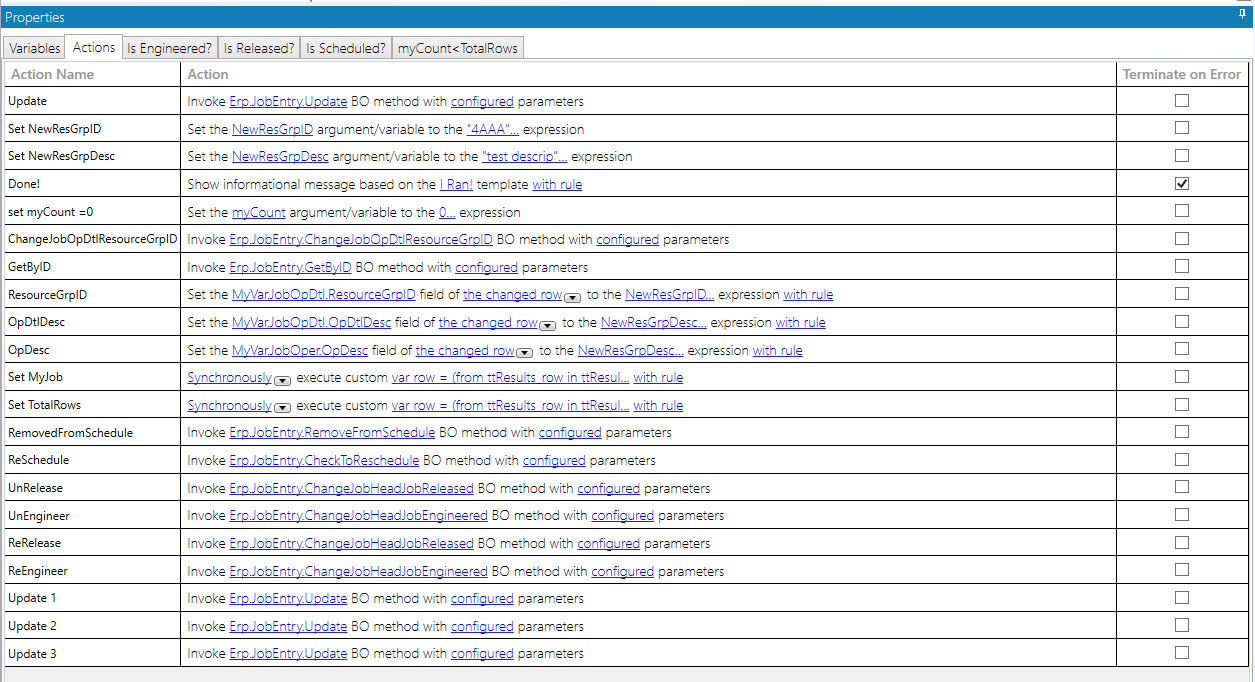

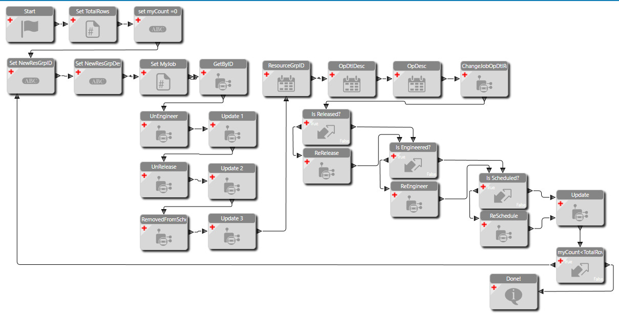

In an effort to implement this criteria, I have updated my BPM to check for engineered and released statuses. The BPM stores these values internally for each row of the query. Then at the end resets the original status based on that variable. Perhaps it is just my ignorance, but I couldn’t find a flag in the JobHead table for ‘isScheduled’. To determine if the job is scheduled, I just checked to see if both engineered and released are checked. If they are, then I assume it has been scheduled. (This is a big assumption on my part! Is there a better flag to check if a job is scheduled?)
Below I have included my updated BPM with all the criteria and BO methods in place. I also included a small portion of the resulting errors.
Here is the updated code for the ‘Set myJob’ widget:

Partial list of Errors:
JobHead has not changed.
Can not remove from schedule, Job is still engineered.
Operation Detail is not available.

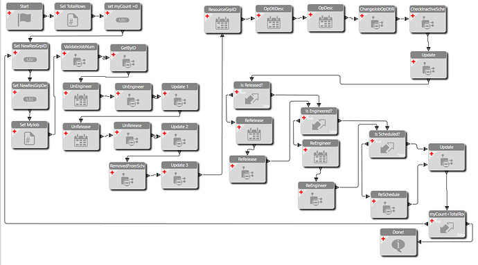

The BPM is huge and ugly now that I included all the extra criteria to check and reset Engineered, Released, and Scheduled.
(My God! Look at this thing! Someone stop me!)

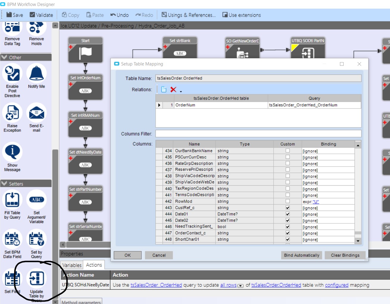

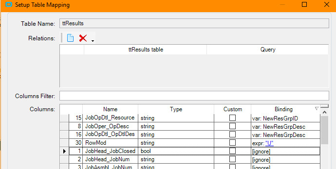

You need to use the update table by query widget.
Might cut down on the number of widgets as well. One stop shop.
This look promising! I get my BPM to run now, and the results in the BAQ screen are updated, but when I Get List from the Analyze tab, I can see the records are not being updated.
For the source query I used the entire ttResults, and for the update query I also used the entire ttResults, with only a few fields modified:
Am I on the right track? Thanks a bunch!
