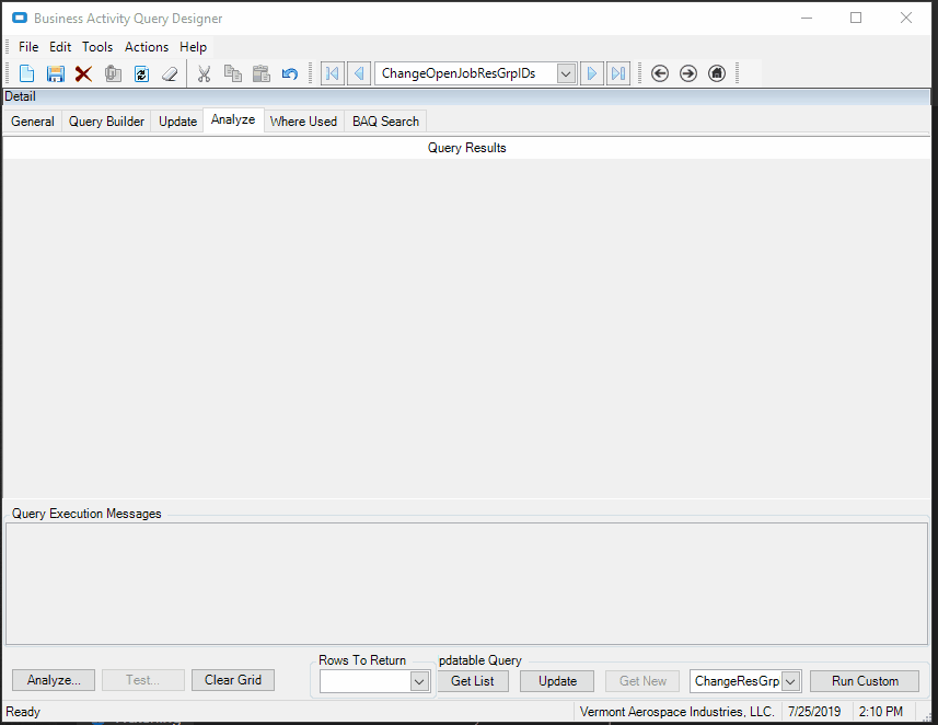

My steps:
  1. Get List
  2. Enter criteria. In this case, find all open jobs with resourcegroupid = ‘4AAA’
  3. Run custom action to update required fields.
  4. Observe resulting message box indicating successful execution.
  5. Get List again using same criteria to see if the record was updated (it wasn’t).

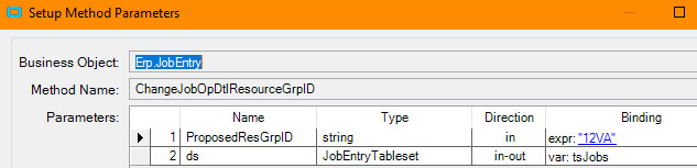

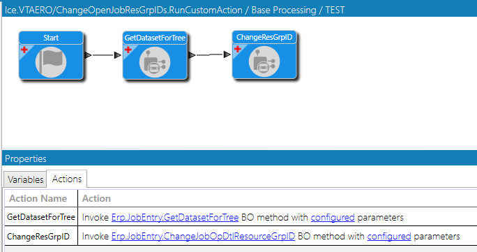

Lets start simple by making only two calls in TEST.
One BO to get the Job Erp.JobEntryGetByID. For now since this is a test hardcode a jobnum.
Then you have your return job object called tsJobs.
Next call the BO Erp.JobEntry.ChangeJobOpDtlResourceGrpID. Note that you can pass the callContextBPMData.ShortChar01.
Does that work? Sometimes, the BO that does the change updates the database. You will need to test that out.
If the database table isn’t updated thenAdd two more widgets to update the tsJobs.RowMod = “U” and then one to run the BO Erp.JobEntry.Update
If you are good to go then do that again with the JobOper. By doing this in steps you will learn how the BO work and what is all going on when you make the calls.
Knowing the trace and then creating the BPM to mimic the trace is an acquired skill, you might drive yourself mad, but you will get there. :slight_smile:

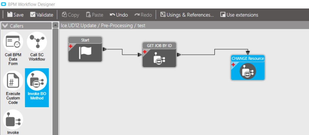

Good morning,
Thank you for taking time to work this out with me. I replicated the TEST method you showed. I keep coming up to the same error when running the ChangeJobOpDtlResourceGrpID method.
Operation Detail is not available.
Could there be something locking up my op detail? Based on Ruth’s input earlier, I also tried to add a method to Change Job Engineering and Released, but these also fail with an error.
Job has not changed.
For clarity, I am not using the callcontextBPM yet, just a hard coded value. Eventually when this BPM is run from my customized dashboard, then I will pass in the callcontext fields that are set by the user.

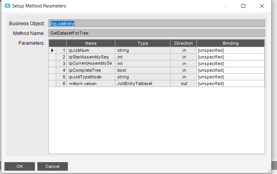

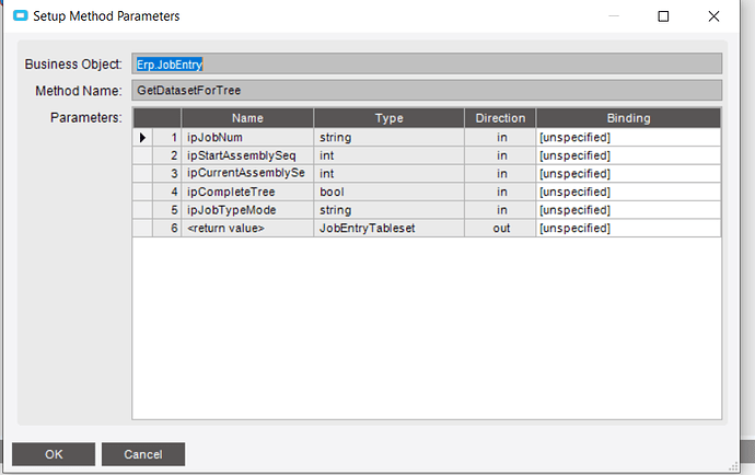

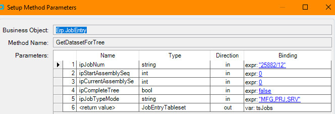

Are you using GetDataSetForTree()? that’s the one that is going to get the data set that you need.
That method will let you populate the JobEntryDataSet with just the asm seq you want. Which makes more sense when the changes only take the change, and not which one needs to be changed.
In the trace utility, compare that method to itself, you should be able to see what was added.
What @Banderson said. The GetID is not the correct BO to use. follow the trace. lol
When I compare the first GetDatasetForTree method to itself I found a few values changed. I assume some method calculates the values for these. I am not sure how I would figure them if I had to update these values myself. Do I need to run UpdateTableByQuery for all these tables/values?

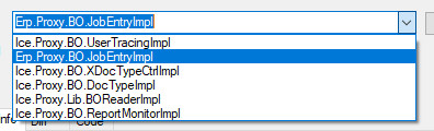

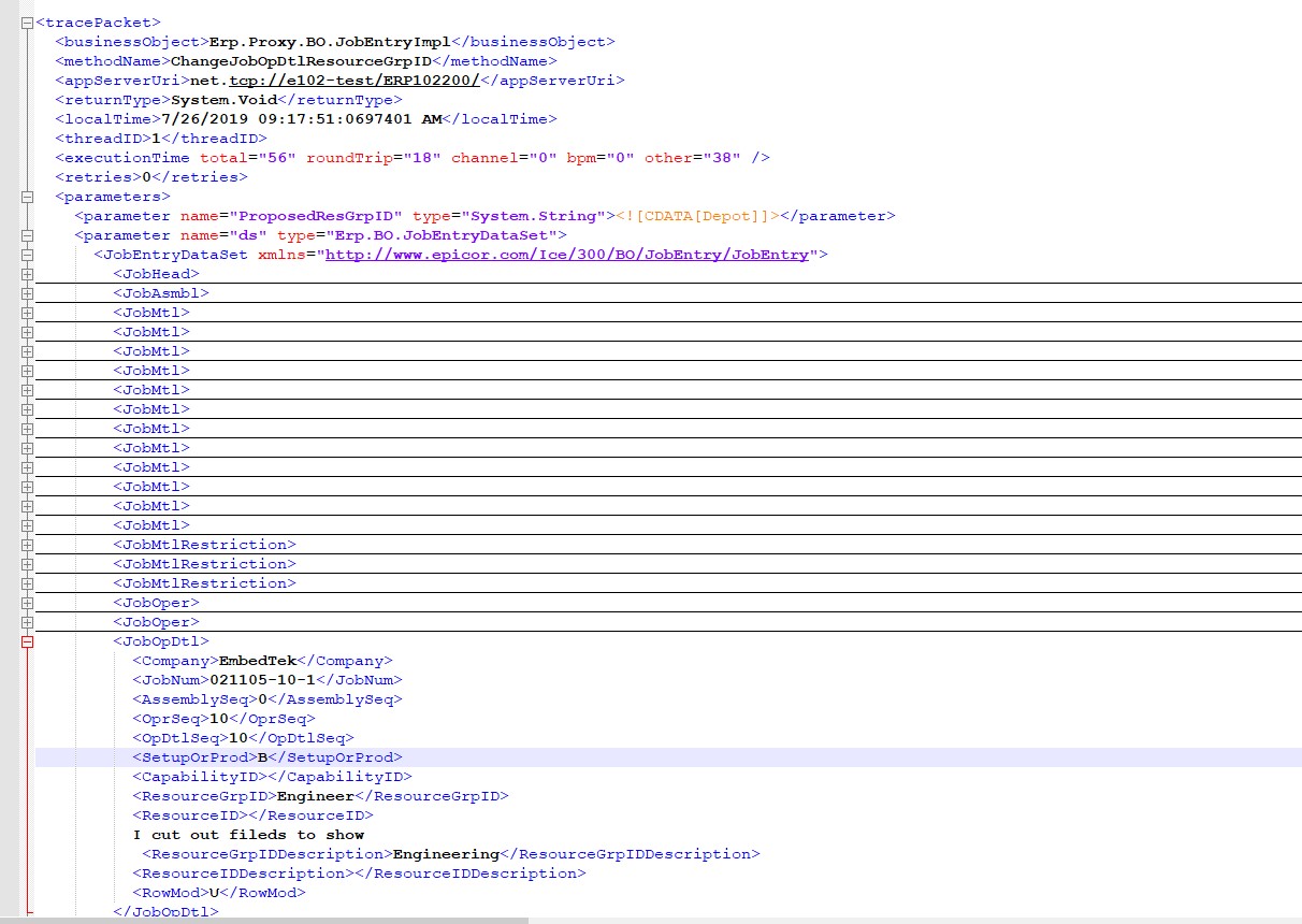

In the trace you should see something like this. This the BO we want to call with the parameters.
<tracePacket>
  <businessObject>Erp.Proxy.BO.JobEntryImpl</businessObject>
  <methodName>GetDatasetForTree</methodName>
  <appServerUri>net.tcp://e102-test/ERP102200/</appServerUri>
  <returnType>Erp.Tablesets.JobEntryTableset</returnType>
  <localTime>7/26/2019 09:17:39:3779206 AM</localTime>
  <threadID>1</threadID>
  <executionTime total="213" roundTrip="168" channel="0" bpm="29" other="16" />
  <retries>0</retries>
  <parameters>
    <parameter name="ipJobNum" type="System.String"><![CDATA[021105-10-1]]></parameter>
    <parameter name="ipStartAssemblySeq" type="System.Int32"><![CDATA[0]]></parameter>
    <parameter name="ipCurrentAssemblySeq" type="System.Int32"><![CDATA[0]]></parameter>
    <parameter name="ipCompleteTree" type="System.Boolean"><![CDATA[False]]></parameter>
    <parameter name="ipJobTypeMode" type="System.String"><![CDATA[MFG,PRJ,SRV]]></parameter>
    <parameter name="CallContext" type="Ice.Bpm.Context.ContextDataSet">
      <ContextDataSet xmlns="http://www.epicor.com/Ice/300/Bpm/Context">
        <BpmData>
          <SysRowID>00000000-0000-0000-0000-000000000000</SysRowID>
        </BpmData>
      </ContextDataSet>
    </parameter>
  </parameters>
When you compare it to itself, you are seeing that the method did. It’s showing the input table compared to the output table.

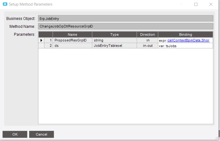

Here is a trace that I did quickly. You should see something similar on your end. Use those two BO calls, see what that gets you.
Yes, my trace looks very similar. I ran the TEST directive with just those two widgets and the same configuration as returned by my trace.
img19 img20 img21
Error Detail
Description: Operation Detail is not available.
Program: Erp.Services.BO.JobEntry.dll
Method: ChangeJobOpDtlResourceGrpID
Line Number: 11770
Column Number: 17
Table: JobOpDtl

ok based on the trace we need to update the tsJobs object.
Note that we are changing to Depot on JobOpDtl OprSeq 10, see the RowMod. We need to set that to U. Using the same process we were trying to do before.
