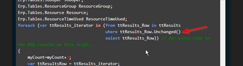

/* update JobOpDtl */
string NewResourceID = string.Empty;
string rgdesc = string.Empty;
Erp.Tables.JobOpDtl JobOpDtl;
Erp.Tables.JobOper JobOper;
Erp.Tables.ResourceGroup ResourceGroup;
Erp.Tables.Resource Resource;
Erp.Tables.ResourceTimeUsed ResourceTimeUsed;
foreach (var ttResults_iterator in (from ttResults_Row in ttResults
where ttResults_Row.Unchanged()
select ttResults_Row)) // for every line in the BAQ results do this stuff...

Could it be that ttResults is only populated for the BAQ view? Do I have to populate ttResults differently when I run from a Dashboard?
I does something different, but I can’t remember the exact details. I seem to remember the the BAQ returned 1 row per, but the dashboard would return the previous and updated row, so it would get double the rows if you didn’t filter it right in the BPM. But that seems opposite of what your seeing.
Could it be changing it, then changing it back?
It is still ttResults. I have never done this with a form. I simply type the new data in the grid and click save. The update runs just like it does in the BAQ.
It doesn’t seem to be changing anything. This is my messagebox.
Updated <myCount/> records!
callcontext: <callContextBpmData.ShortChar01/>
var: <NewResGrpID/>
action id: <actionID/>
You can see myCount is increased as the first line in the foreach of ttResults.
When I run in BAQ I get “Updated x records!” But in the dash view it says “Updated 0 records!”

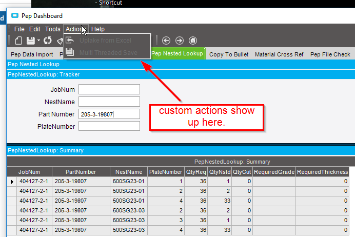

I think the code I used from @josecgomez for executing the custom action might be the problem.
While the code does execute the custom action, it seems to do so on an empty ttResults table.
private void BAQRunCustomAction(EpiDataView iEdv, string iActionID)
BAQDataView BAQView = (BAQDataView)iEdv;
Assembly assembly = Assembly.LoadFrom("Ice.Lib.EpiClientLib.dll");
Type t = assembly.GetType("Ice.Lib.Framework.BAQUpdater");
BindingFlags bf = BindingFlags.NonPublic | BindingFlags.Public | BindingFlags.Static | BindingFlags.FlattenHierarchy;
MethodInfo mi = t.GetMethod("BAQRunCustomAction", bf);
object[] param = new object[] { BAQView, iActionID};
mi.Invoke("Ice.Lib.Framework.BAQUpdater", param);
I won’t pretend I understand exactly how this little function works.
Can you see anything that would let me pass in ttResults? (the current contents of the epiUltraGridC1 might work)
Edit: I think it may be because the BAQ needs the parameter passed in to populate the ttResults. When I click button 1 I pass the parameters in through the callcontextbpm data field (pulled form the textbox). But when I execute the custom action I do not pass this parameter. This could be why ttResults is empty. How can I pass that parameter using the code above?
Well it does it on the dataview you pass in. So that dataview should contain the dataset you want to apply the changes to.
Custom actions require the results to already have been populated. That is the data passed in.
Do you have any idea why the ttResults table seems blank then?
Hmmm is the DataView you are passing actually a BAQResult which would match what the BAQ is expecting?
I see… hmm I wonder if you are having to pass a rowmod?
Do you mean passing a rowmod inside my custom action code? Like in the where clause of the ttResults iterator?
No like passing in the “modified” Row that is the Row you need to / want to pass in. If that makes sense.
Just for
and giggles. Can you remove the where clause from your loop once?
Or add another loop before it, just to get a count of the rows.
In the original it was !ttResults.UnChanged() as in it was changed. Now it is only looking for unchanged rows which are not passed into ttResults.
No. But I thought that was because I setup a blank dashboard with a blank tracker view. Then I added all my components manually.
I am not sure what you mean.
I actually did remove that where clause as I could tell it wasn’t needed. The BAQ processes correctly without it, but the change had no effect on the dashboard.
I think this worked for your example because you were manually clicking in the UBAQ and editing a value. I am passing in all values of the BAQ and stepping through each one to update the ResGrpIDs. I pulled the where out completely so that ALL rows of my BAQ would be processed. Does that make sense?
