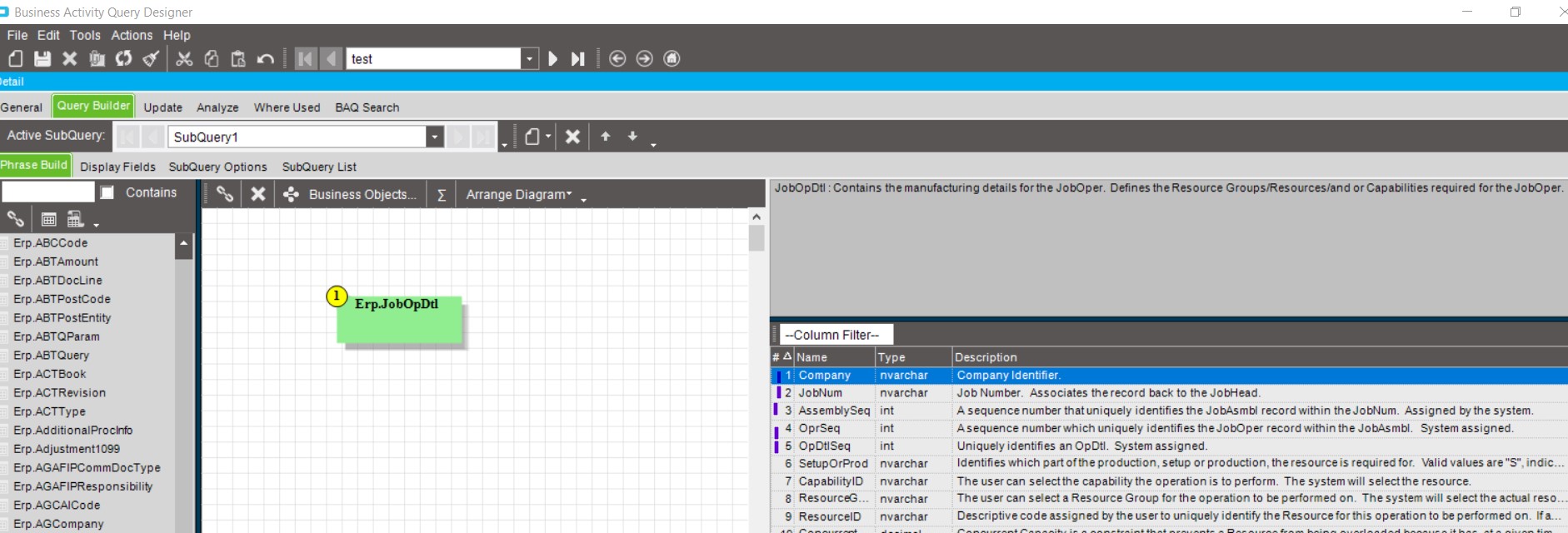

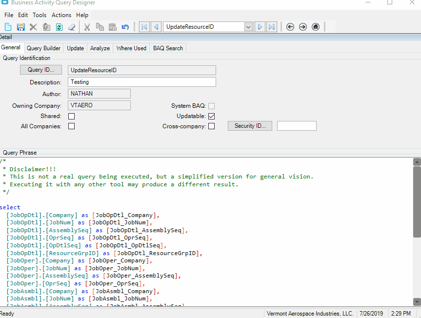

Just a regular updateable BAQ works fine. I think we are just over complicating it.
UpdateResourceID.baq (31.5 KB)

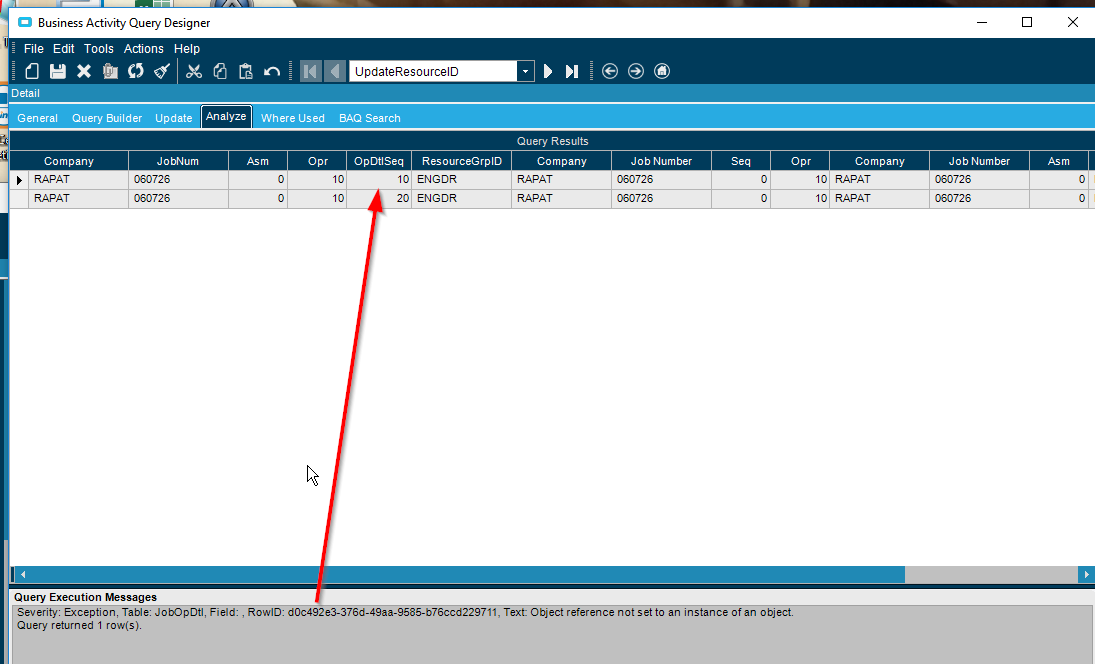

Using your uBAQ, I only changed my job number and got this error:
Severity: Exception, Table: JobOpDtl, Field: , RowID: dedc528f-428f-40e3-a632-558e8c55f93e, Text: Object reference not set to an instance of an object.

Here’s the other issue, it looks like you can’t change the primary resource. it works on OptDtlSeq 20 but not 10.
This is what I get when I try to change 10

Ok got it working on a test here. Got the same error message you are seeing regarding the primary.
The query to update the table using the widget needs to be the table you are updating not the ttTable.

@knash Ken are you calling ChangeJobOpDtlResourceGrpID in the last BO? That is how Epicor goes behind the scenes and changes the RG and also the ResourceTimeUsed data. I have not figured out any of the wizards yet or I would do a test. But I think the other post referenced here is about that method being currently broken. I have a UBAQ that changes an entire job from one resource group to another since we move jobs all of the time. I will make a sample without all of our odd requirements.
