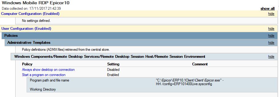

I use Group Policy for this. I’ve put the screenshot because typing out the path to the policy seemed hard work!

I just checked Group Policy on the main Epicor Server (it doesn’t exist on the terminal server) and it doesn’t look like any users in the company have group policy configurations. Where do I modify a Windows user AD account profile? MSDN says I can access this under Administrative Tools, but “Active Directory Users and Computers” isn’t listed on that menu for us on either the main Epicor server or the terminal server.

On the terminal server, you could try checking the Resultant Set of Policy plugin.
Start
Run
mmc.exe
File, Add/Remove Snap In
Actions, Generate
Logging Mode
This computer
Select the handheld device user name
Next
Finish
Now check the location that I posted on my screenshot.
