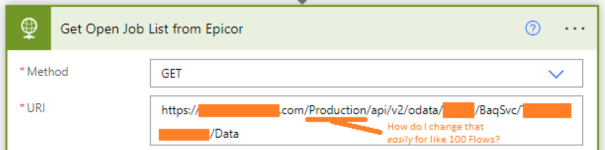

I apparently have made close to 100 (Power Automate) flows over the last 3 years or so that ping Epicor.
Well, now we are planning to switch the URL that they connect to, to separate the traffic. Just the slug part (the domain.com/endpoint part) will change; obviously the other stuff is standard Kinetic-REST syntax.
I don’t expect this to be quick, and that’s fine. I’ll live.
But my question is, how could I have done this better if I had known that this would happen?
Like, in Postman I can set an environment variable and then it’s easy to change everything. Any analog in the “Power Platform” world?

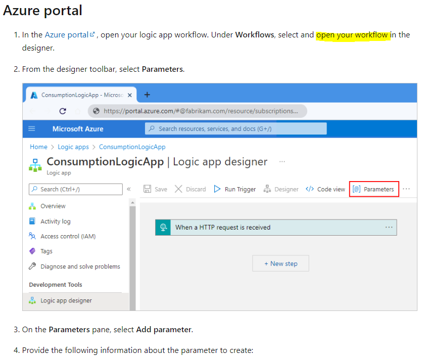

Not sure about PowerAutomate, but in Logic Apps, there are parameters that can be used to build your URL. Maybe you can steal something from there? If nothing, it would be cool to have one for production, test, pilot, etc.

So, it depends. . There is a concept of an ARM template, which is an ugly Json version of the resource. In this case, if you put all of your workflows in one ARM file, you can use a template variable that gets assigned to the various parmeters in each workflow.

ARM templates (which can also be described by BICEP), are the actual definitions used by Azure to change the infrastructure. They describe resources and services and Azure implements them from the JSON ARM file (ARM = Azure Resource Manager).
