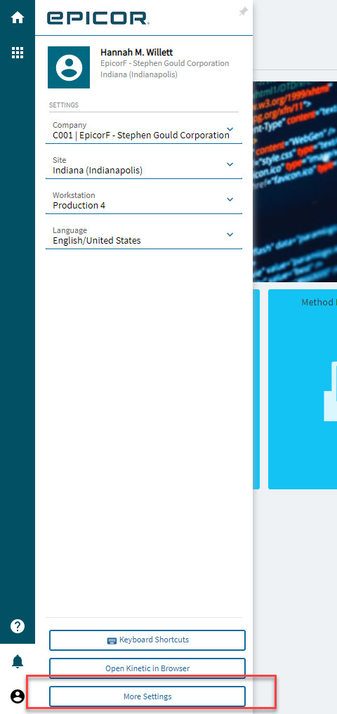

We are on version 2022.1.9 aka 11.2.100.9. I am wanting to know if there is a way in the smart client, not the web browser UI, to change the currently logged in user account. We have our app servers setup to use SSO and it automatically signs in with the currently logged in windows account. I’d like to be able to still have the ability to change to a different Epicor user in the smart client if possible when I need to switch over to the security manager to perform security functions.

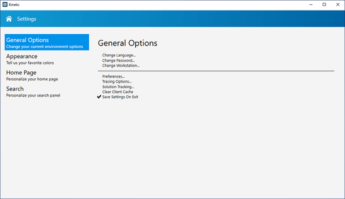

I do not currently have that top option available to me.

Is change user in the triple dots in the top right of the main menu along with Developer Mode?
I did check there and “change user” is not an option from that menu.

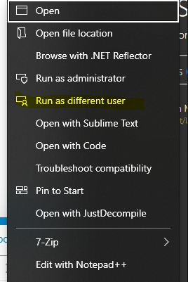

But also remember SSO may set the user some jibberish password, which you may not know. So another option you can try is, if you hold SHIFT and Right Click on your Epicor Shortcut, you could run the Client as another User, and that may pass-thru:
Holding SHIFT and Right Clicking on the Kinetic shortcut and then choosing to run as a different user worked.
