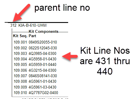

We have this problem too. The newly added components do indeed get sequentially added to the end, for line nos. We’ve wished many many a times for the ability to resequence sales order lines. I can understand some of the difficulties of this (e.g. already tied make direct jobs, btos, etc…) but one can dream :slight_smile:
Here’s a real ugly one (section of SO acknowledgement) we had a few months ago where the kits were getting changed after initial order entry. The sales order pick list was real fun!
HTH nancy

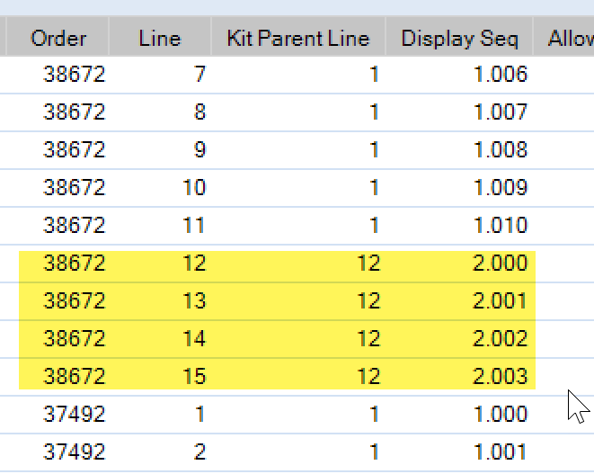

The column in your picture labeled “Kit Seq”, is that really OrderDtl.DisplaySeq?
Do you know if this can be altered without breaking anything? Like if I have an order with 100 lines, and line 50 references lines 51-55. And then someone says wee need to add a line but it needs to be inserted between 55 and 56 (with line 50 now referencing lines 51-56).

IDK if you will be able to manually change the DispSeq field. Maybe try an updateable query and see if it lets you? Looking at a query, we see the related data of order / line / kit parent line / display seq from order detail. Maybe as long as Kit parent line is in there, you can do what you want with display seq…
