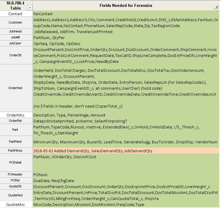

We started off change logging a ton, which grew the size of the DB a lot (and folks wanted to report on unstructured text too, ugh!).
Since then, we’ve really pared back what is change logged, and also purge the change logs monthly with a 2 year cut-off. We use it to figure out how unintended changes happened, then train users to not make them (or lock down the fields if needed).
Here’s our list:
