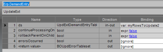

Option 2 would be to put a post-processing directive on the uBAQ BPM, and Invoke the DemandEntry BO to call UpdateExt Method, and update each DemandDetail record.

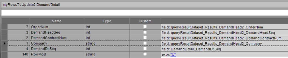

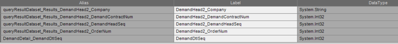

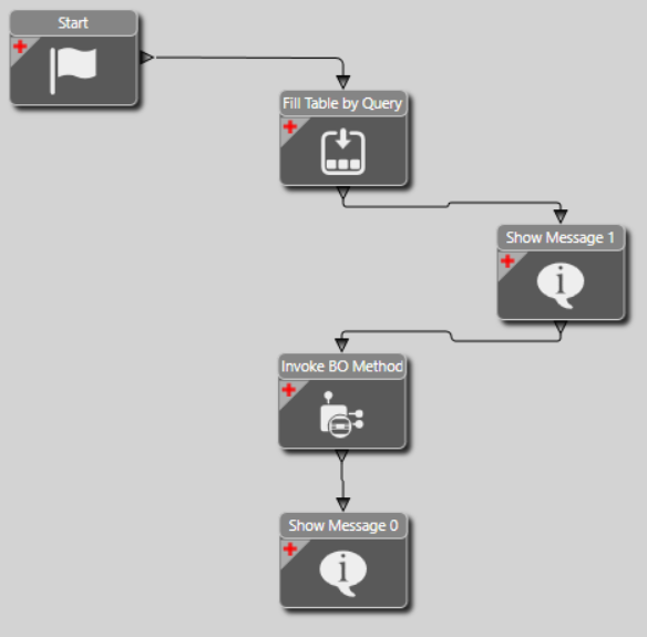

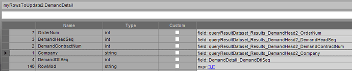

I opted for option 1 as it seemed simple enough. Having stood up the base bpm with the following settings:
Fill Table by Query 1
Invoke BO Method 1
The two message boxes in there can be ignored as the first just gives me a readout of the data before the updateext runs and the other just tells me when its done.
The data shown in the message box seems to say it should update correctly:
But when I checked the detail entries after they were still the original number, not the one I had entered (ie 2222).
Ideas on anything I missed?
My first thought is that it hit an error somewhere. Can you create bpm level bool variable (called HasErrors or something), and assign it to that 4th parameter of DemandEntry.UpdateExt, and add a condition after that to show a different message if the HasErrors variable is true?

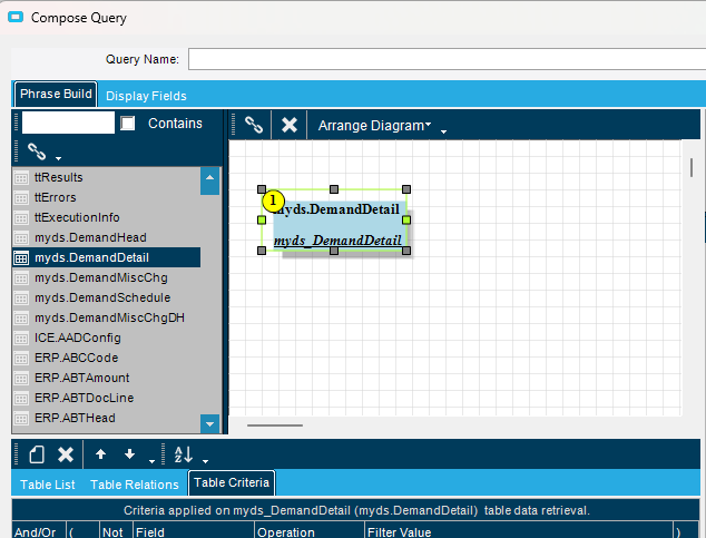

Looking back at that, I think there’s a little more that needs to be done. You’re passing in the BAQ Results with updated rows, but the ds that UpdateExt is expecting is probably a full DemandEntryTableset.

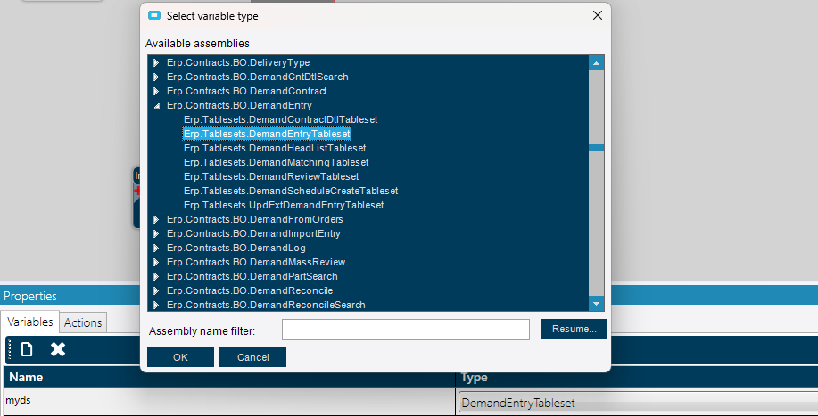

If I’m right, this may be just a little more complex than I expected. First you’ll need to create a new variable of type DemandEntryTableset using the “Choose Type” option when setting BPM variables:

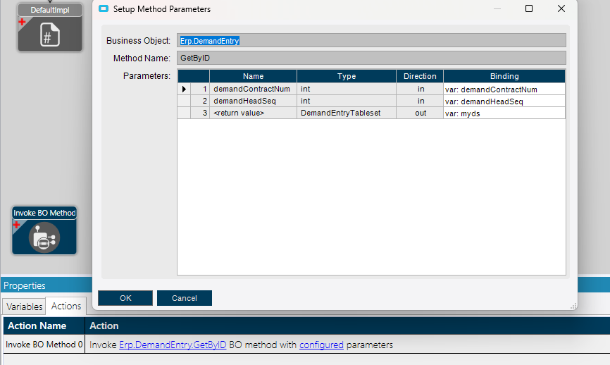

Then you’ll need to invoke GetByID from DemandEntry:
Then do your Fill Table by Query using that Tableset, instead of your Query Results tableset:
This worked perfectly! Thanks a ton for the help!
