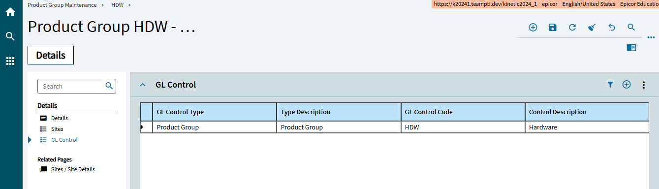

Yes. Epicor uses G/L Control Codes to determine the accounts used. If you call up Product Group, you will see each group can have a different G/L control.
G/L Controls choose the account number, and if you use several books, you can pick those as well.

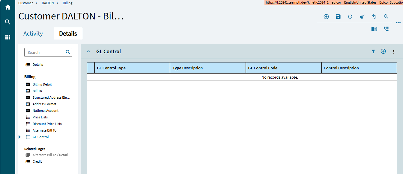

Also affecting A/R, the Customer has a G/L Control, so you can change behavior there, as you mentioned.

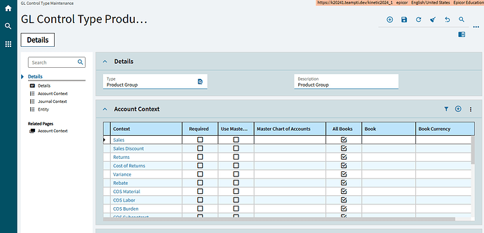

I think Company and Customer are the only places where you can set the AR Account type GL Control. The controls available for Product Group do not change the AR account posted to by the invoice.
You can add account contexts to the GL Control types but that will require customizing the posting rules to implement, which is not a simple customization. As far as I can tell, this won’t happen out-of-the-box.
