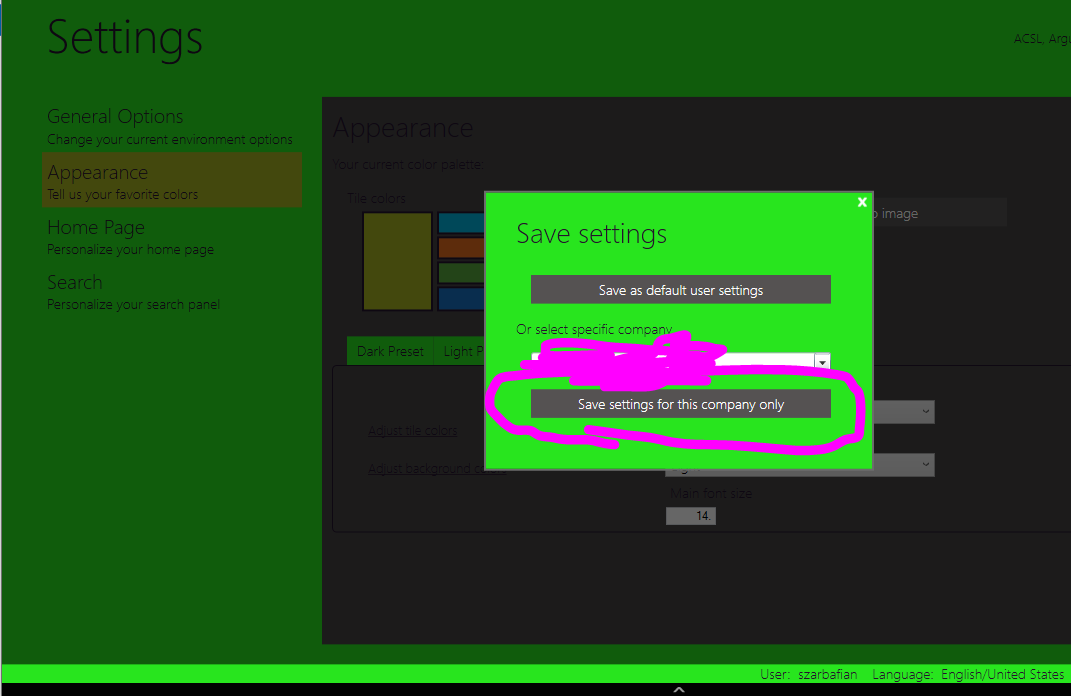

@Shizar115 What @bordway is pointing to will allow you to change the classic screens. I do this for the top and bottom bar’s colors. If you want to do the background you will need to have Can Publish Home Page Layouts set for your user.
From settings > Appearance Advanced Setting > Adjust background colors You will need to create and save all of the layouts you need.

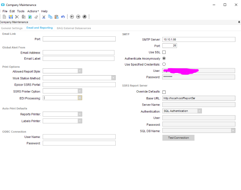

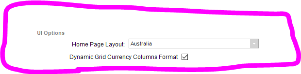

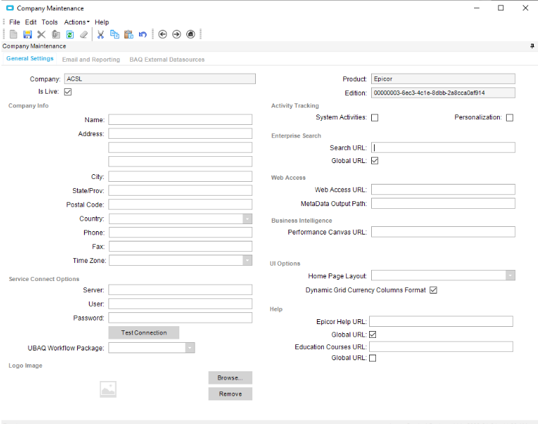

In Company Maintenance pick the layout you want to be the default.
Users can overwrite this and those settings are saved in Ice.ShellLayoutPersonal
I really appreciate your response.

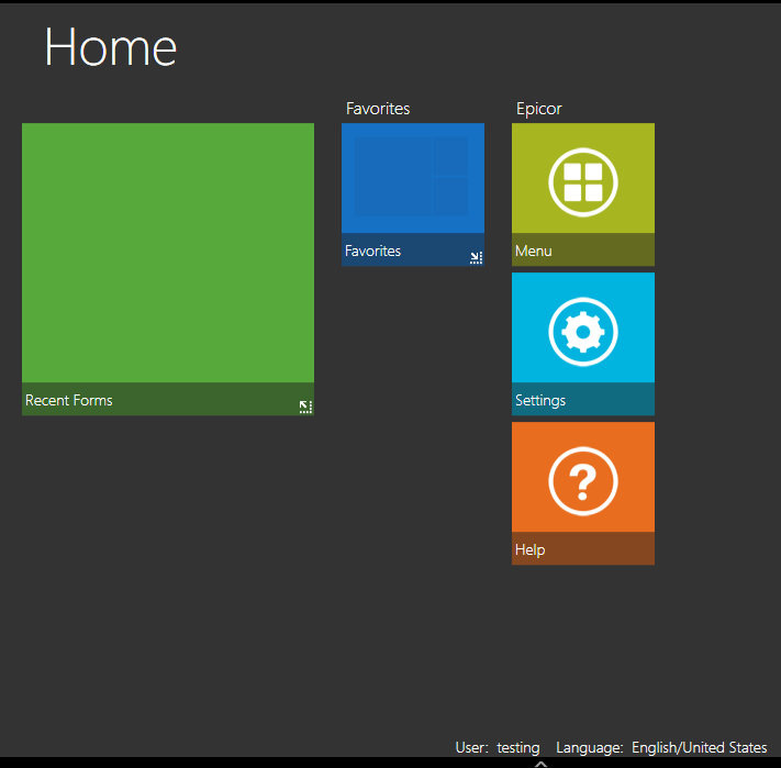

I followed the steps as you suggested, however I am not sure where to publish the changes.

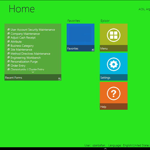

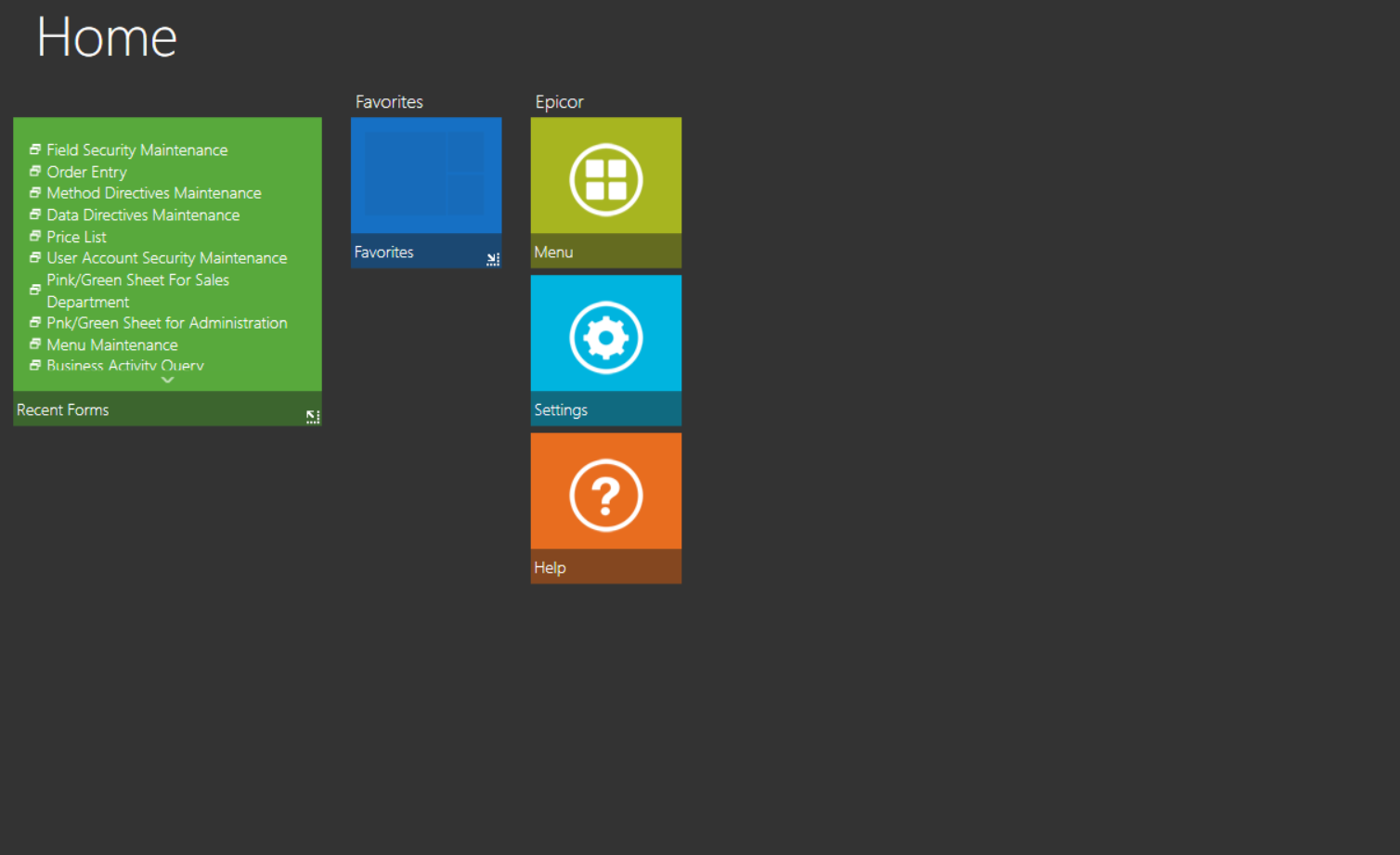

After making all of the changes, I created a test user and everything is the same for the home screen:
Thank you @bordway
As Greg said this is not what I am looking for but I appreciate your response.

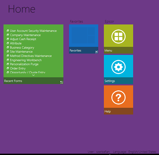

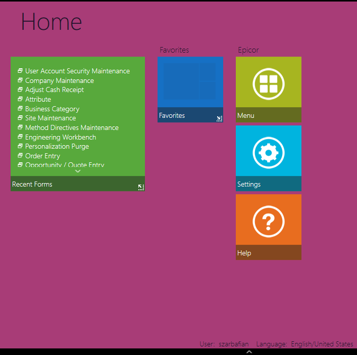

What I need to achieve is changing the home screen in Modern View of 10.XXXX Epicor version

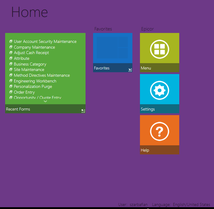

I have encountered an issue.
After deploying the layout, when the user adds a new square to their homepage, the layout defaults back.
