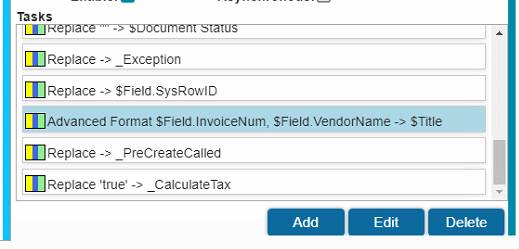

@Beth You need to check in the workflow for where it is referenced. I know you have said you are v2, but also only header footer and not line groups. Bring up your workflow designer (hopefully in a dev environment) so you can document the workflow. The default V2 is called IDC PO Invoice. After it is loaded the under actions on the right pick Generate Documentation. This should create a PDF of the workflow that is just in alphabetical order. search for title and you should see something like this that sets your invoice, ID and Name.

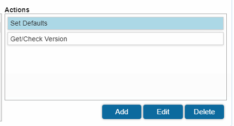

Scroll up from there and you will find the action where it is set and then further up you will find the step name. Mine is called Auto-Index Invoice and has an action of Set Defaults.
Highlight then click Edit
The find the action you found in the PDF and click it then edit.

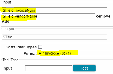

Based on you having three fields ( or is Invoice # like mine?) you should have three inputs and in the Format {0},{1} and {2}
Change the order of the Input fields and if you want type in three values and test.
Ok the Task, then the Action then the step.
You will see the name is now in italics. Click save
