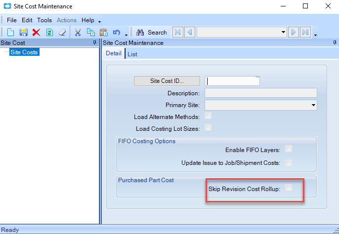

You could specify not to roll up the methods for purchase part (company wide) when you do a cost roll using costing workbench.
Under Inventory management > Setup > Site Cost Maintenance.
  • Select the cost ID
  • Check the BOX that says “Skip Revision Cost Rollup”
In this way, if a part is coded as purchase it will ignore it’s method (BOM/BOO)

If you use the setting shown above, you should simply be able to switch from Purchased to Make and do a rollup to recapture the labor/burden/etc
