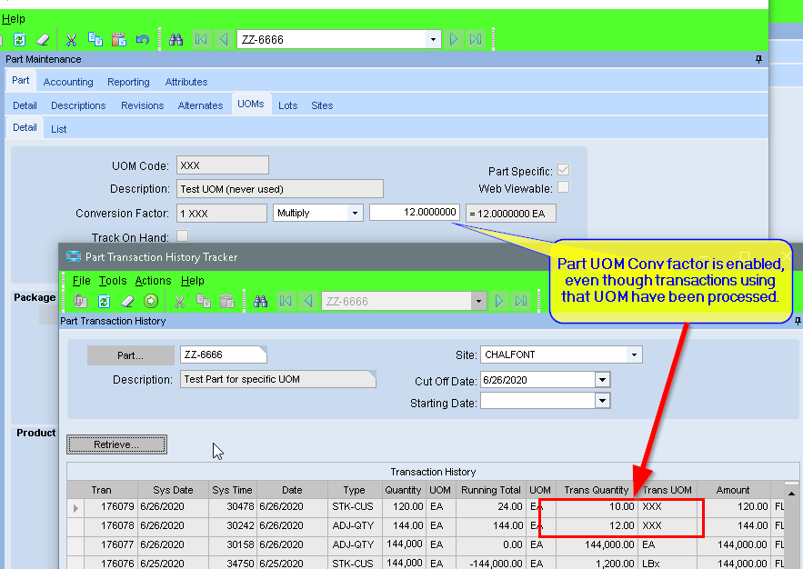

I did some testing on a part with a Part Specific UOM. After several different transaction types, I was still able to change the conversion factor.
  1. Created parttrans via Qty Adj, could still change the factor (even with non-zero QOH)
  2. Used on an Order, could still change the factor
  3. Customer Shipment against the Order, could still change the factor
  1. Created a PO using the Part & UOM, and could no longer change factor
  2. Received the PO (thus closing it), and could no longer change factor
Pretty much anything I tried (unreceiving, reopen PO and change UOM on line, zeroing out QOH, etc…) and the UOM conversion remained locked.

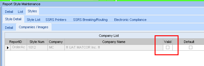

One last thing to try … Make a uBAQ, to see if it can be changed there. Sometimes its the UI that prevents chages from actually happening.
For example, if you have only one Company, unchecking the "Valid for company " box on a report style, won’t be saved.
But in a uBAQ I made, I can change it, and it remains saved. FTR - this property isn’t a Boolean of whether the style is valid, but rather a string of the list of Companies it is valid for.
You don’t even have to make a dashboard. Make the uBAQ and the changes to the updatble fields can be done with the Analyze tab.

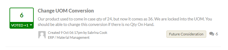

@ckrusen @jbowen07 I had the same problem… So, I got this feature request vetted through the Epicor Ideas, currently in the “for future consideration” status. Now, all we need is enough votes to have the Dev team give it some serious consideration.
If this is a feature you would use, please go VOTE for it! You will need to get access to the Epicor Ideas portal first. Support can get you setup. :slight_smile:
Search for UOM
https://epicor-manufacturing.ideas.aha.io/ideas/ERP-I-485
