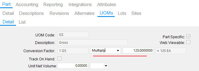

@Jonathan where you specify the UOM Conversion Factor is grayed out so i can’t change it.

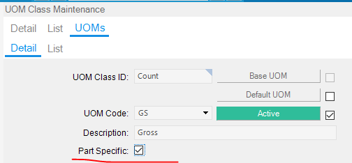

So you mean below fields are disabled? I enabled this by marking the Part Specific box on the UOM Class.
I will check if there is any other validation to disable the ConvFactor besides this.

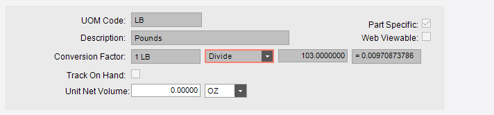

@Jonathan this is what it looks like for me.
Found it, looks like these fields are disabled when PartUOM.HasBeenUsed is true.
There is also a field UOMConv.HasBeenUsed but that is more general.
You can update this to false at your own risk. As mentioned before the factor is pulled from the setup when a transaction needs it so there is a risk of data corruption.
