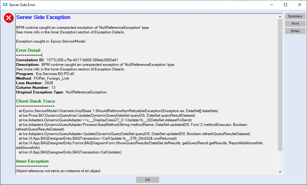

The first is a Null Reference Exception that occurs when I try to change the UnitCost on a PO Line that has more than one Release. I’ve never had this error occur when there is only one release on a line, and I don’t know why this would cause an issue. Also, the exception only occurs after the save has been made, so the goal is reached, but I don’t want the users to see a Null exception whenever they do this. Here’s the message.
