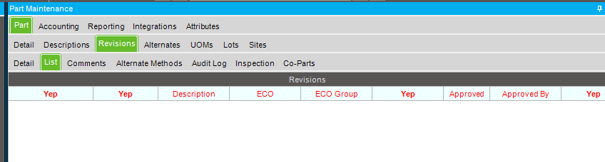

Short answer:
Slightly longer answer:
EpiUltraGrid ultraGrid1 = (EpiUltraGrid)csm.GetNativeControlReference("86fb7bf3-f52e-4d9a-9d96-30551ee51ecf");
		ultraGrid1.UseOsThemes = Infragistics.Win.DefaultableBoolean.False; //True;   //either works, but setting this to false kills ALL of the theme on this control.
		int colCount = 0;
	    foreach(var col in ultraGrid1.DisplayLayout.Bands[0].Columns)
	        // Here we "turn off" theming for the column header.
	        col.Header.Appearance.ThemedElementAlpha = Infragistics.Win.Alpha.Transparent;
	        col.Header.Appearance.BackColor = Color.Azure;
	        col.Header.Appearance.BackColorDisabled = Color.Orange;
 	       col.Header.Appearance.ForeColor = Color.Red;
			if(colCount++ % 2 == 0)
				//col.Header.Appearance.FontData.SizeInPoints = 18;  //want a bigger difference?
				col.Header.Appearance.FontData.Bold =  Infragistics.Win.DefaultableBoolean.True;
				col.Header.Caption = "Yep";
