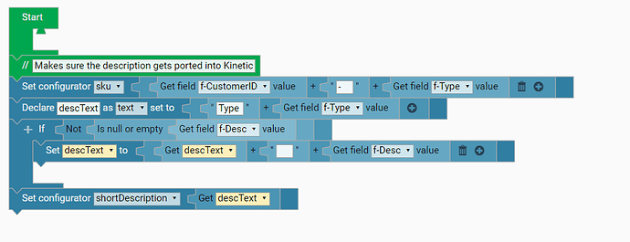

We decided to update the line item part number in CPQ so that we can create an intelligent part number based on CPQ input. Even more fun we bring in the Customer Number from the Quote and make that part of the part number. We use a Naming rule to update the Configurator Sku, then that gets sent to Kinetic.
This has been working for us fine until the latest update 2024.1 (We are still in pilot phase so running on our THIRD environment). The best part is any Configurators setup in Kinetic after the 2024 update doesn’t work but the ones created prior to 2024 update still work as expected :frowning:
Example:

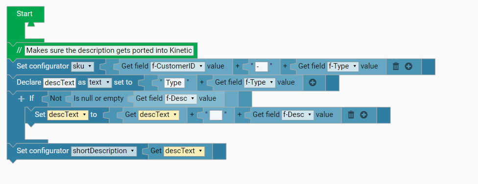

Current naming rule
Older product will properly push back a line item part number based on this formula.
Configurators create since the update retain the configurator part number used in Kinetic.
AND… the ShortDescription does work for both older and newer configurators???
Put in an EpiCare case. Possible a bug got introduced with 2024.1…

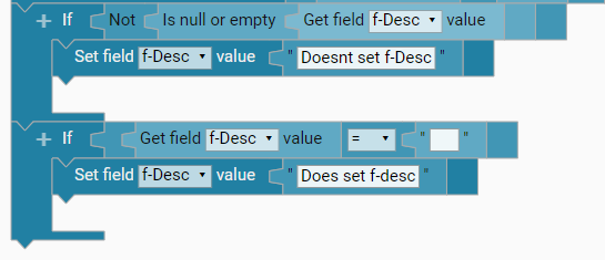

If the f-Desc field is a text field, you might be able to fix this by checking if f-Desc = “” rather than saying if Not is null or emtpy. f-Desc might not be null or empty it might be = “”
Hope this helps

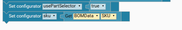

I was able to set the configurator SKU by first setting usePartSelector to true.
Hi credler,
Excellent post and super on point. We ended up finding the settings back in Epicor and were able to accomplish this, but I never considered your solution here. This opens some interesting options!
