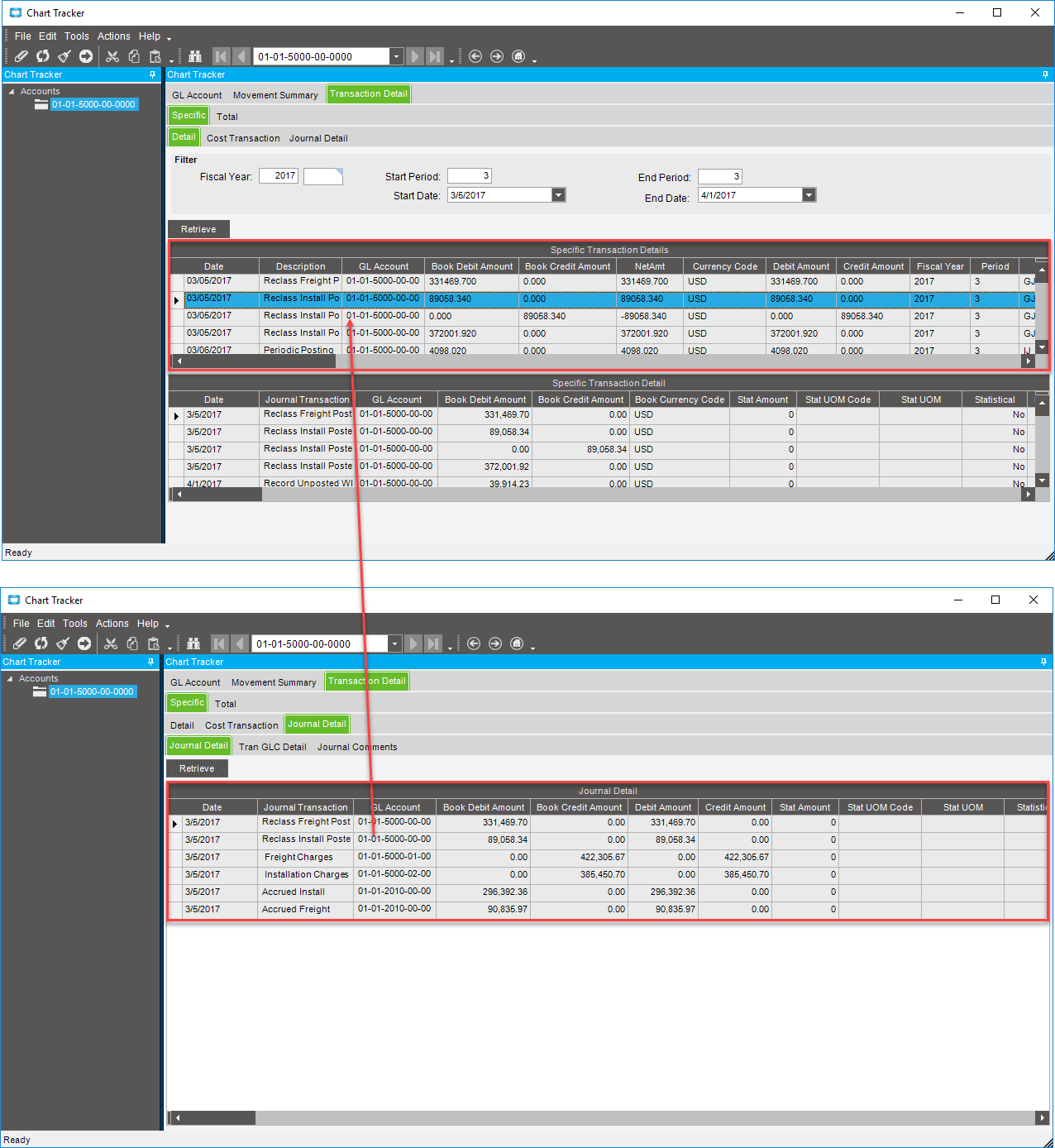

I created a BAQ View in chart tracker to pull some extra information that was requested.
I had troubles rebinding the original grid to my BAQ, so I plan on hiding the old one.
It pulls data just fine into the new BAQ grid, but what doesn’t happen is the link between the Transaction Detail and the Journal Detail/Tran GLC Detail/Journal Comments grids.
What’s the best way to get the 3 grids to subscribe to my BAQ view instead of the old Transaction Detail Grid?
