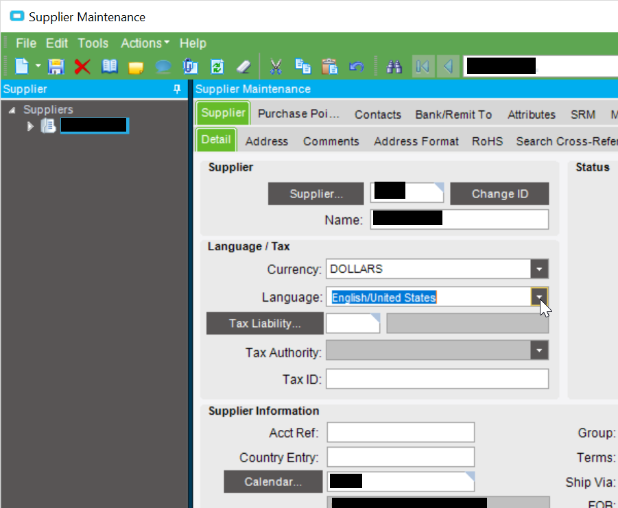

Yeah, i worked on it, but never touched the language. I also need to restate that there are others printing out like this as well. Is this the place where the language is selected for the checks to be printed?

Pretty sure? We don’t mess with it, but from the field help:
Language
Select the language used by this supplier from this list. This language will be printed on all reports sent to this supplier - such as quotes, sales order acknowledgments, AR Invoices, PO’s, labels, packing slips, and so on. For example:
  • Paris Plastics Inc. is based in France, so you need your PO’s printed out in French. Select French on this supplier record’s Language list. All fields on PO’s sent to Paris Plastics are printed in French. If you have a part description written in French, this will appear on the PO as well. However, any data entered on the PO will appear in the language it was entered.

So we had one company set to Hebrew in the Lang setting in Supplier Maint, and all others nothing. We removed the Hebrew and it worked correctly.
