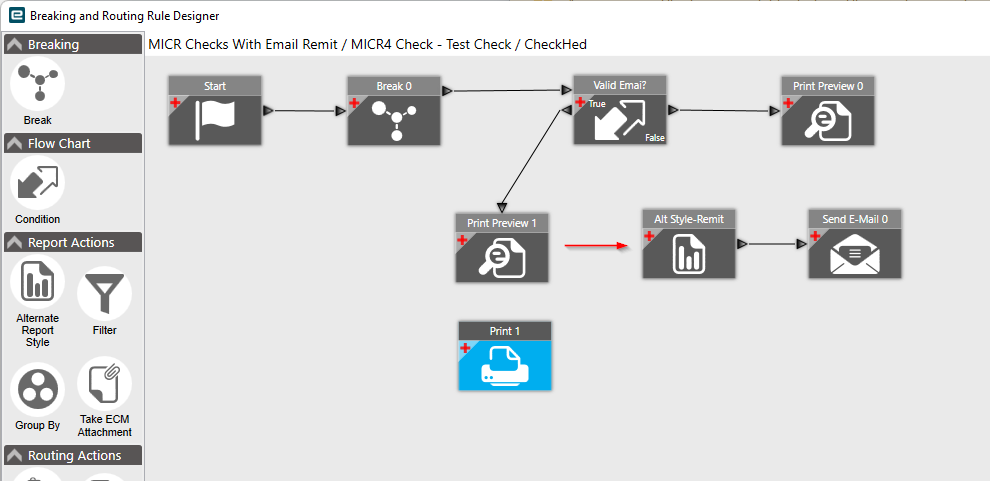

We want to print the AP check locally as normal and also email the remittance advice. Here’s an unfinished breaking/routing set up, where I’d like it to print the check, change the style to one that prints only the remittance advice, and then email it.
It won’t let me connect the print box to anything else.
Has anyone done something like this without having the user do a separate print run just for the remittance advice?
