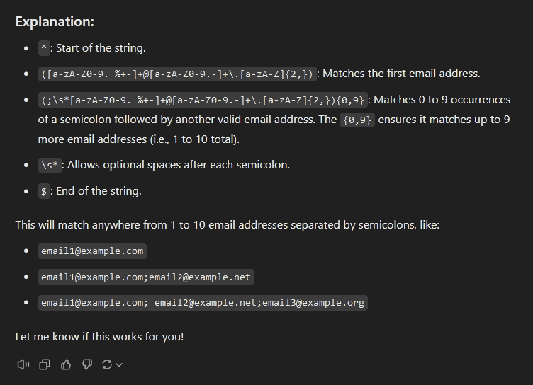

Chat GPT does a pretty good job of helping out with regex formulas. This is what it gave me back.
^([a-zA-Z0-9._%+-]+@[a-zA-Z0-9.-]+\.[a-zA-Z]{2,})(;\s*[a-zA-Z0-9._%+-]+@[a-zA-Z0-9.-]+\.[a-zA-Z]{2,}){0,9}$

I think if you replace {0,9} with *, then you’ll have none or many, instead of being limited to 9 additional emails after the first one…
Edit: confirmed this on regexpal dot com…
