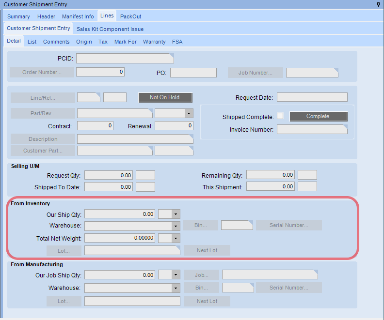

Due to some frequently repeated user errors, we have decided to modify the Customer Shipment Entry screen to disable the “From Inventory” form controls when a user adds a line/rel to the pack that has been marked “Make Direct.”
The field that I am looking to check for is OrderRel.Make but I am having issues grabbing a hold of that data in the script editor. I’m fairly new to the more in-depth parts of form customization like Adapters and that stuff so I’m in that “I don’t know what I don’t know” kind of area.

The form controls I am tasked with disabling.
