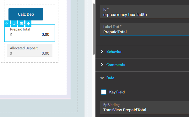

Classic Screen Customization totals the Prepaid Invoice Deposits and fills a Text Box with the result

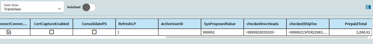

Do you see a number in TransView.PrepaidTotal column? If so it is left or right justified? I wonder if it’s a string vs number issue.
Yes
Everthing checks out my friend. I got nothing else to offer I’m afraid. Suppose you could try a regular text box, but your math is good and your bindings are good. Only thing I can think is something else is wiping out your TransView row after the calc or something is preventing standard binding from bubbling up to the box. I’m still most suspicious of the currency box tho.
Text box:
Yup. You could try looking around for this ToggleCurrency checkbox but I thought this only applied to grid columns. Eitherway its a bug.
Or it’s a string vs num problem - still a bug:
