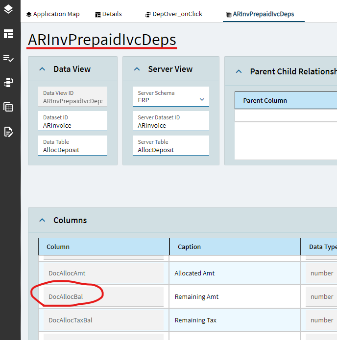

I can see the ARInvPrepaidIvcDeps dataview when I look at what’s available in Application Studio.

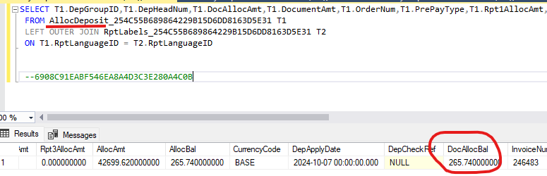

The AR Invoice print shows me what I’m chasing.
But This is not a Table I can find - AllocDeposit

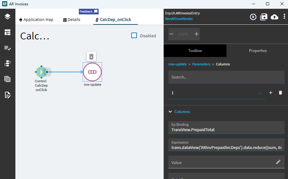

Functions are great and everything but if the data is already in a client-side dataview, and you simply want to sum the rows for display purposes, you could do so client-side like so:
Add a button (because you need a trigger)
in Onclick event use row-update action
to set TransView.PrepaidTotal
with expression:
trans.dataView('ARInvPrepaidIvcDeps').data.reduce((sum, item) => sum + item.DocAllocBal, 0)

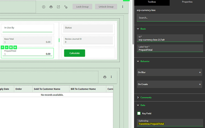

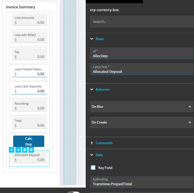

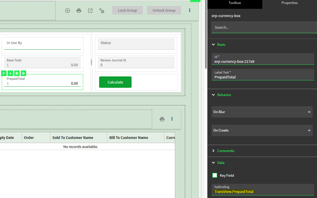

Add the Currency Box and bind it to TransView.PrepaidTotal
Done.
Josh,
Thanks for your time.
I tried to follow your details.
Button is made - row-update added - onClick filled
Currency box - EpBinding as you detail.
But when I open an Invoice in Test that I know has overpayment, nothing happens when I click the button:
I added a message for testing:
I guess the math is working.
I’ll refocus on the Currency Box.

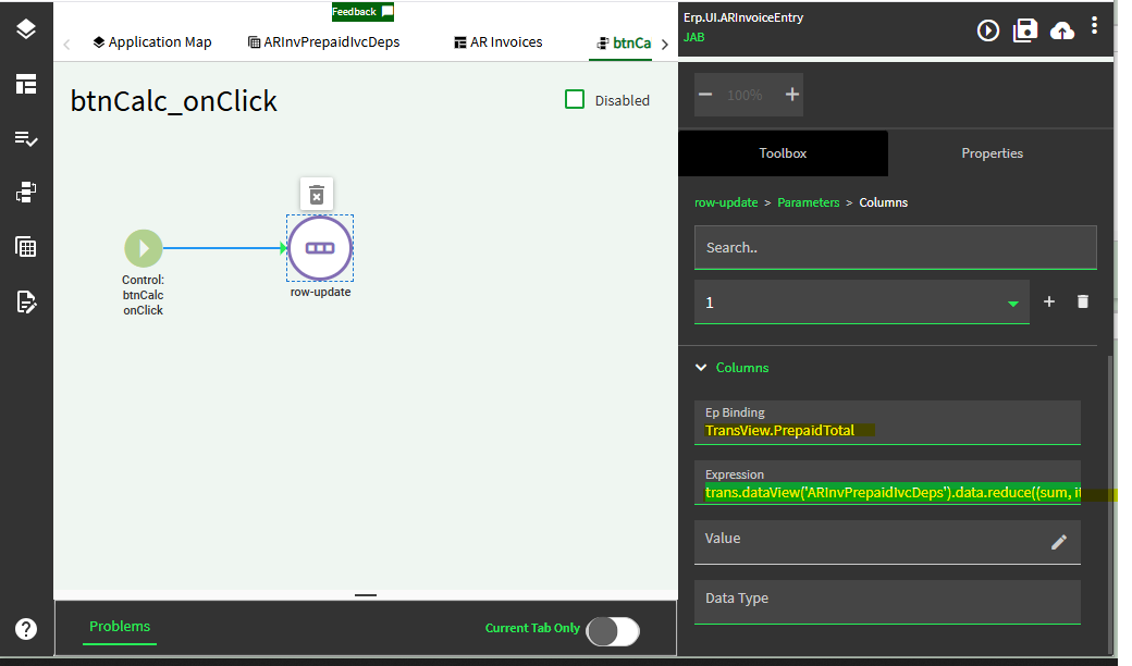

Hi Ben,
I don’t seem to have Prepaid Totals so the expression is going off what I see on your post and I cannot prove it. Please confirm:
Your dataview is indeed named: ARInvPrepaidIvcDeps
and the field is named: DocAllocBal
and that there is data in the view.

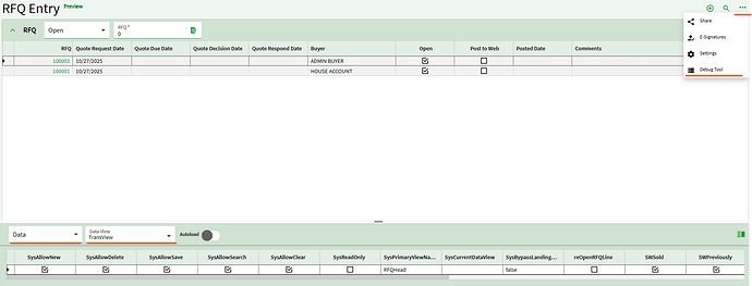

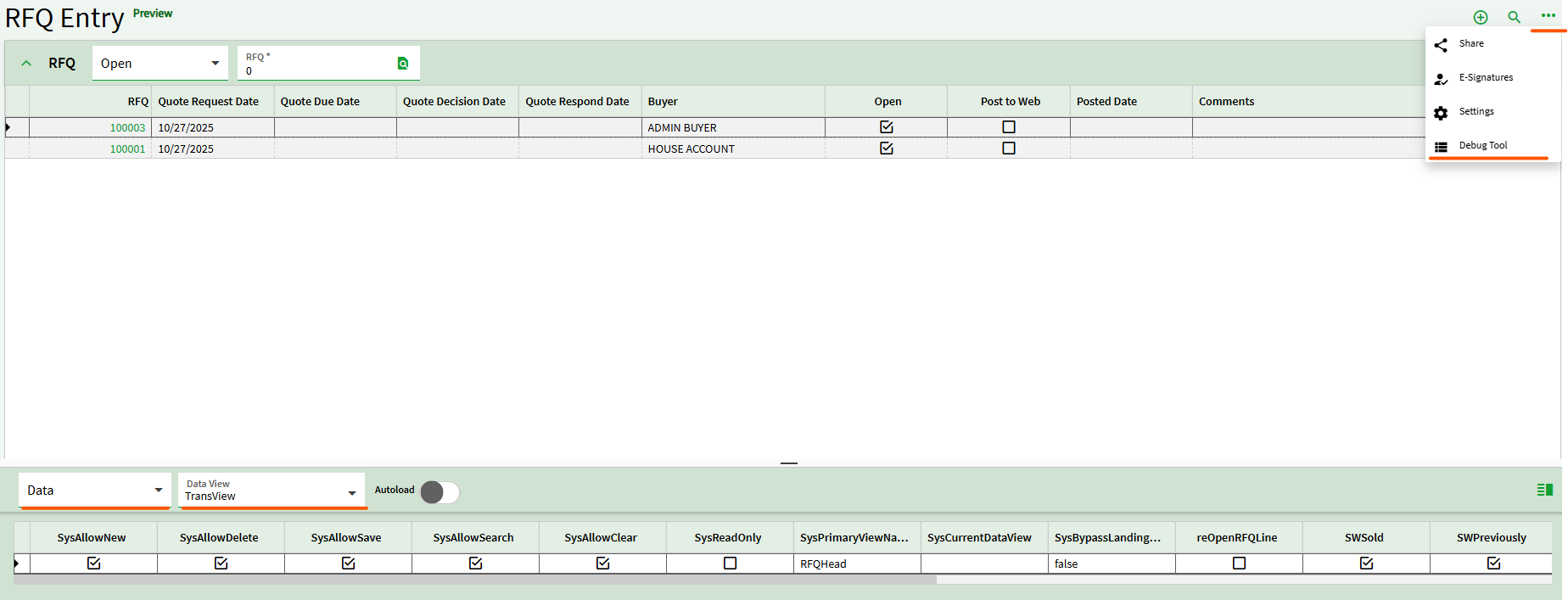

You can do that by previewing and choosing Debug Tool then Data > ARInvPrepaidIvcDeps and see that there are rows with DocAllocBal values in there
Looks good now prove there’s data in there at runtime preview.

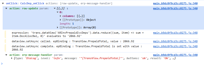

Looks good and I see you were able to prove the calc in a msgbox. Next I’d look in TransView dataview to prove the result lands there as it should. Lastly, look in your browser console for errors. Hint: Preview > then Debug tool > then F12 > then press the button. What do you see in the console?
PS - are you expecting 2066.92 or 1058.90?
I’m expecting $1058.90.

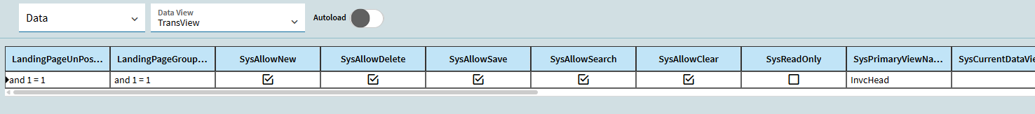

What am I looking for in Transview?
Good. That’s what you should see in TransView .PrepaidTotal after button click.

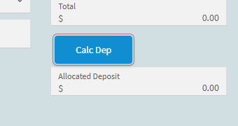

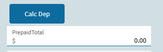

So everything is apears to be working except you still see a zero in the currency box, correct?
That’s correct
