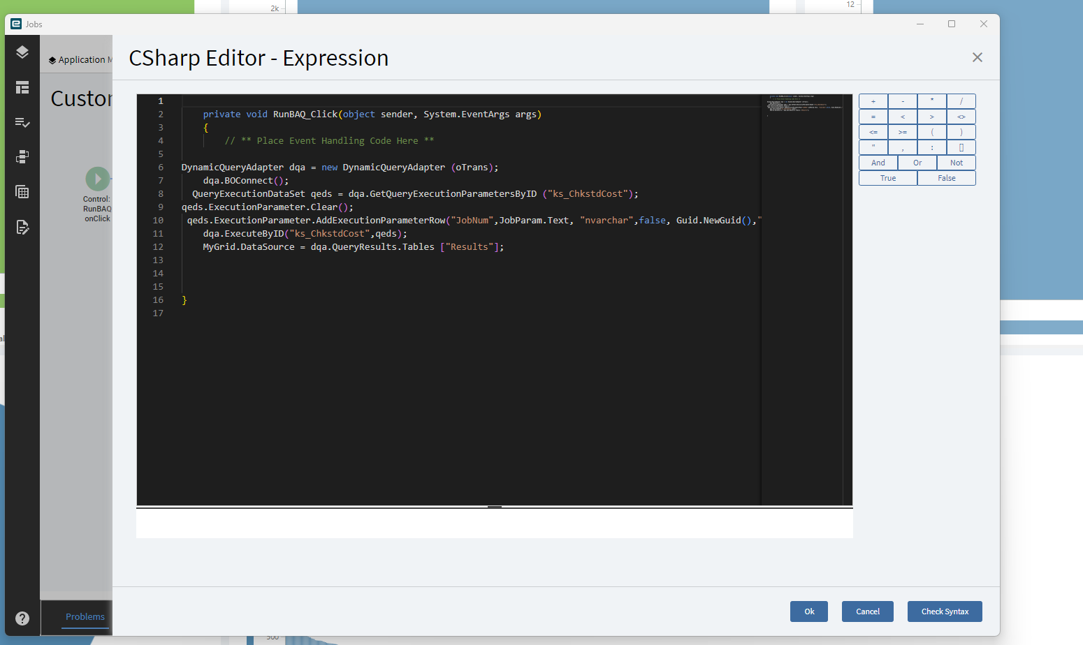

I have a button in the Job Order Entry Screen (Classic) that runs a baq and returns the result in a grid on the screen.
In Kinetic the button doesn’t seem to be doing anything. I can’t find where to trace what is happening/not happening on the click of the button.
I checked the configuration Upgrade Dashboard and that customization says it was successful.
The c# code in Application studio is below. The check syntax button doesn’t seem to do anything either.
Any help would be greatly appreciated.
Hello Kevin,
I’m afraid that this type of solution no longer works in Kinetic. There is a way to run BAQs from Application Studio, so maybe step back and tell us what this code is trying to do - from a business perspective without any technology terms. What is the ultimate purpose of the customization?

Just to clarify your second sentence. Did you mean there is NO way to run a BAQ from Application Studio?
There most certainly is, just not from C# code. You’re running in a browser. The Application Studio way is to have an event that runs the BAQ and the result is put into a DataView. You would then map the result to a component on the page.

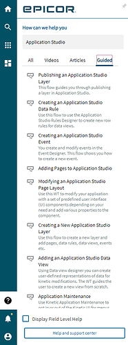

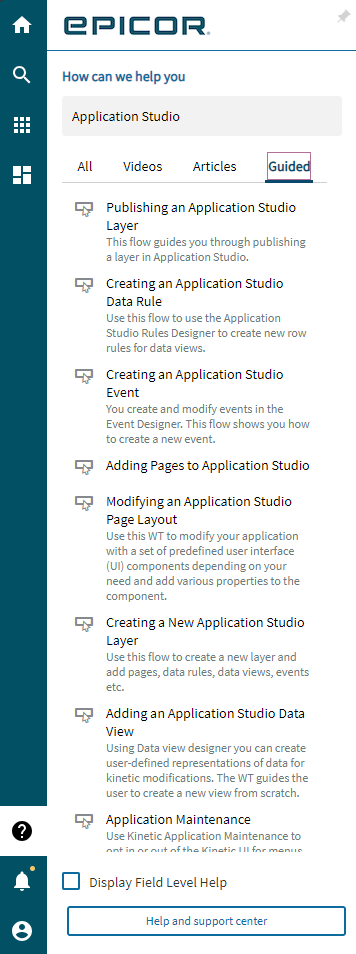

If you haven’t watched the Application Studio help, I highly recommend that before starting down this path. Good Guided directions, Articles, and Videos.
