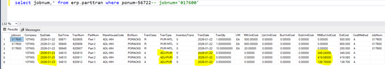

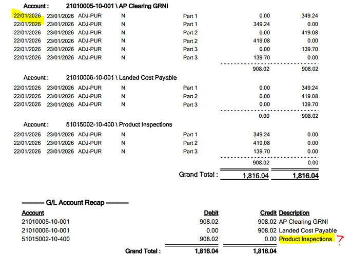

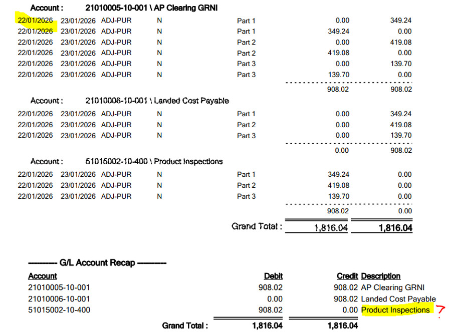

I want to identify which gl control code was used for ADJ-PUR transactions generated after CLCE costs are disbursed and applied to variance.
(For context, I’m testing what happens if we disburse CLCE costs linked to a Purchase direct job mtl that has already been closed and shipped.)
I did a test in Pilot, and it debited a wrong account, so I want know where I can change it, but I cannot find it.

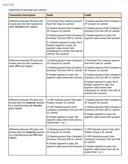

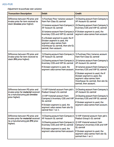

this is ADJ-PUR and it possible controls
