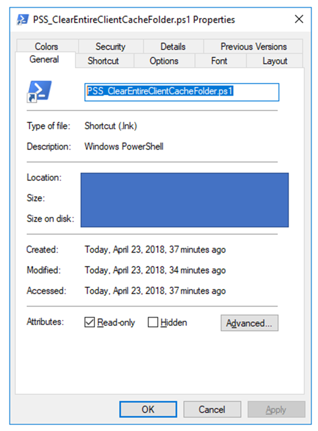

Save this code as a PowerShell (.ps1) script to a unadvertised shared network location. I called my file PSS_ClearEntireClientCacheFolder.ps1 (for reference below).
Create a New Shortcut and point it to this PowerShell Script:
Shortcut - Target Path Example:
C:\Windows\System32\WindowsPowerShell\v1.0\powershell.exe -ExecutionPolicy RemoteSigned -command "& ‘\ \servername\EpicorStuff\Epicor10\PowerShell\PSS_ClearEntireClientCacheFolder.ps1’
Move Read-only shortcut to shared network location where Users can run it from their Systems.
Just FYI: If you Shift + right-click on the Shortcut and choose Run As Different User and enter a domain Admin login and password you can use a $ClientCacheFolder path like: \ \PC27\C$\ProgramData\Epicor\erplive-808 in the script and run it remotely. Not that you couldn’t do this manually but maybe this would be helpful to run this way? (Just be careful changing the $ClientCacheFolder path if others are using the script maybe make a copy for Admin usage.)

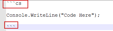

Could someone please remind me what you have to start and end a block of code with to get it to display inside a code box? Thank you! :slight_smile:
Most of these work here for other goodies:
