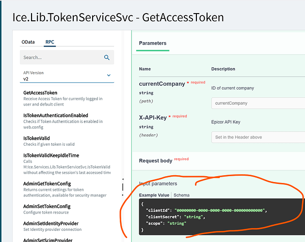

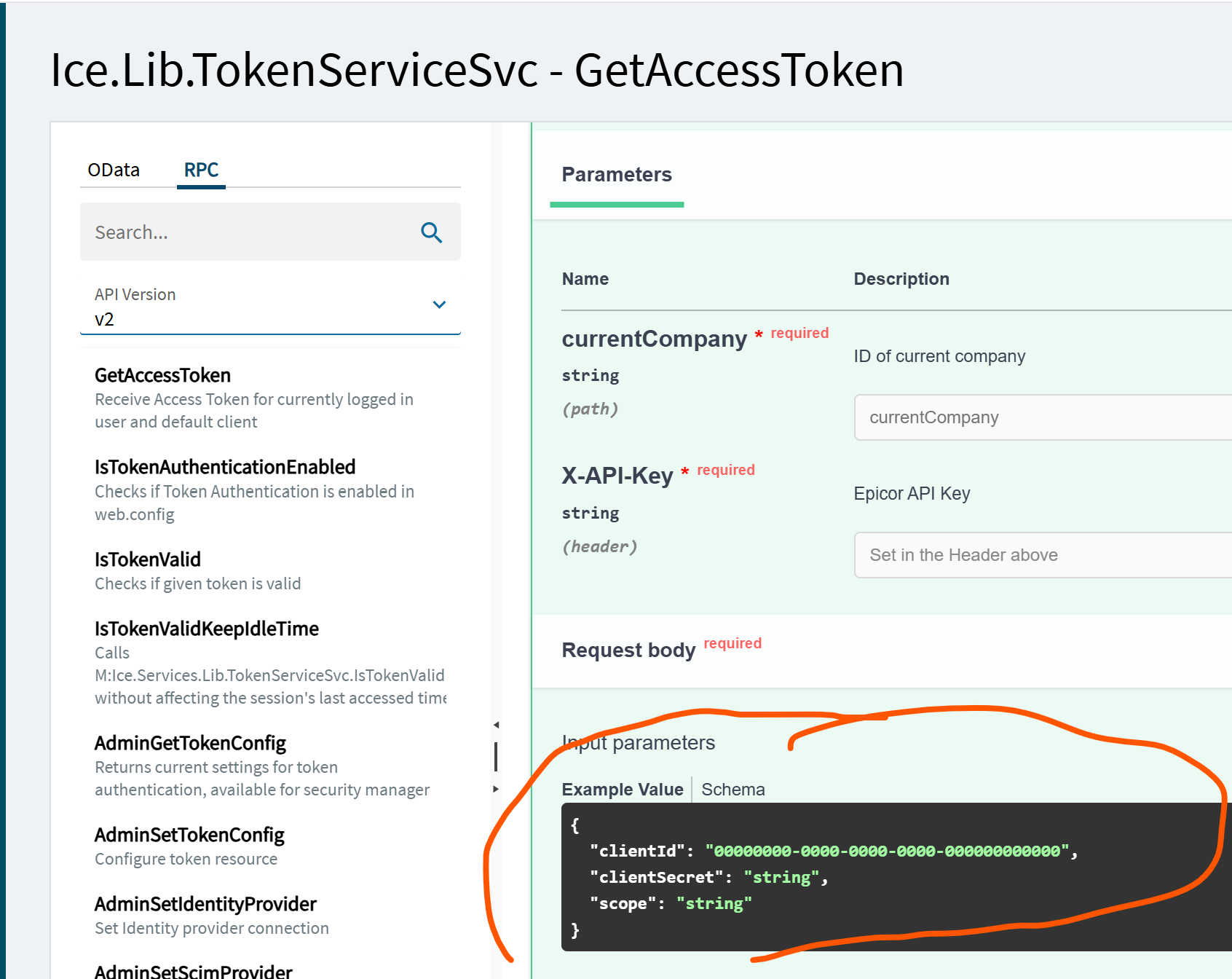

It just seems non-standard for no good reason - meanwhile the endpoint supports client/secret but we’ve no way to utilize it.
I have IDP + Azure and cannot find any docs on how to do an app reg auth flow into ERP APIs.

You know… you aren’t gonna like what I found when I poked at it
Lets just say it doesn’t support… client flow and leave it at that

TokenService only gets new internal tokens for currently logged in users. ClientId and secret there are not used and probably will never be because it was suggested to not continue with that implementation and use standard providers instead. That is Azure AD and IDP.
