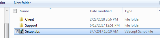

Similar to Hannah’s we use a .vbs which uses robocopy.exe that Setup.vbs can be invoked manually or used as a package via SCCM or GPO. I like Hannah’s script, his actually has the client in a .zip - where mine is literally 900mb unzipped, it was a quick config.

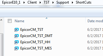

The Support folder contains robocopy.exe, .NET (if its missing it will install it) [ we can control that via SCCM too ]. Whatever you put in ShortCuts folder or Client folder, it will copy it and even compare, skip it if it already exists.

Of course DEV, TST you get DMT. TRN and PRD you don’t get DMT Icons or even the .licx
