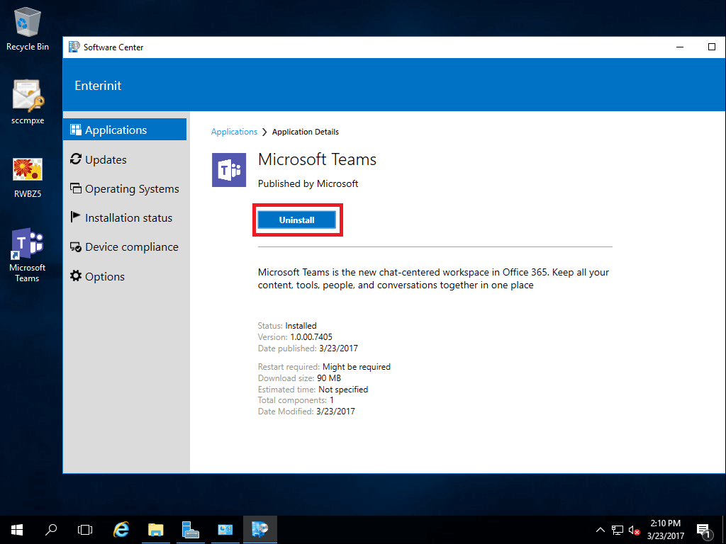

We have this because we use SCCM which gives all users a “Software Center” for self-serve. But you can also configure SCCM to do pre-requisite packages.
This is basically how SCCM looks like on the Client Side:
@hmwillett Im definitely going to have to use the .zip version… Imagine every update 1000 PCs x 900mb lol thats like what 1TB in Bandwith. Probably even use 7z
We have Maintenance Windows and we use SCCM to deploy the Updates. So when the users come in the next day, we don’t want Epicor Auto-Update launching at 7am on 500 computers at once lol… so we do it all after hours, so users don’t have to Auto-Update.
But if you have less than I dont know 50 PCs, you are prob fine with Auto-Update :slight_smile:

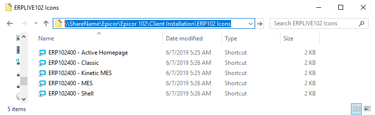

Just FYI, these are my Icon Shortcuts that get copied locally (we are going to have to make a decision on which ones to use and keep eventually…these are all just for testing purposes right now):

$E102LocalIconsPath = 'C:\ProgramData\Microsoft\Windows\Start Menu\Programs\Epicor Software\Epicor ERP10.2 Client\ERP102\'
$IconsShortcutPath = '\\ShareName\Epicor\Epicor102\Client Installation\ERP102 Icons\'

    #Create new Icons Folder and Copy Shortcut Icon links from a Shared Folder on the Network into it
    New-Item -Path $E102LocalIconsPath -ItemType Directory -Force
    Copy-Item $IconsShortcutPath* $E102LocalIconsPath -Recurse -Force
