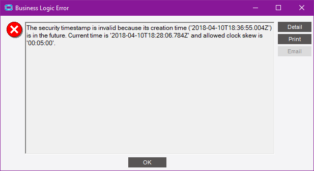

I am getting the following error when I open Company Configuration on m Pilot DB all of a sudden. The clock on the E10 Server and my workstation match. After clicking ok I can make changes to the company config and save. The error pops back up again when I try to re-open company config, it just has a new time in the future. Not sure what is happening here, anybody seen this before?

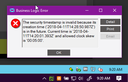

Thanks all for the replies. As stated in the original post, the workstation and the server have matching time. I also checked the ntp settings, and the are both matching. Both client and server get time from our DC and both ntp clients are operating correctly. What’s weird is it thinks my workstation time is a whole 8 minutes faster than it really is, according to this screenshot.

Business Layer Exception
The security timestamp is invalid because its creation time ('2018-04-11T14:43:20.223Z') is in the future. Current time is '2018-04-11T14:34:30.597Z' and allowed clock skew is '00:05:00'.
