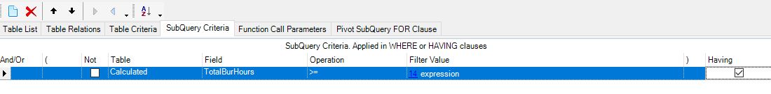

Hi, I am creating a baq that shows users clocked in for more that 14 hours. I have created a baq selecting all user clocked in. And, I have created a calculated field that compares the current date and time with the clocked in date and time and determines how many hours they are clocked. Now, I want to use this calculated field to limit my selection to those users clocked over 14 hours. Now, I can’t a was to limit my query based on the calculated field. Any suggestions would be appreciated. Thanks.
Sorry, I just figured it out with a sub-query… Please disregard. Thanks
I generally use the SubQuery Criteria tab for the main query. Choose ‘Calculated’ from the table list, then pick your calculated field and set your condition and filter values.
