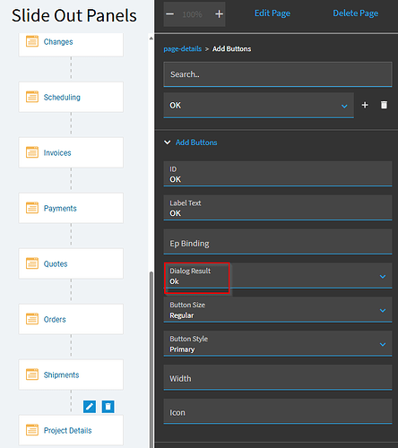

Here’s the slider panel and button.

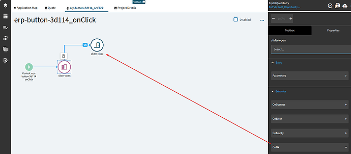

Here’s the onclick event, and it looks like to me I have the OnOk set right:
But the slider doesn’t close when I click the OK button. I added a Cancel button and that didn’t close when I added slider-close in OnCancel, either.

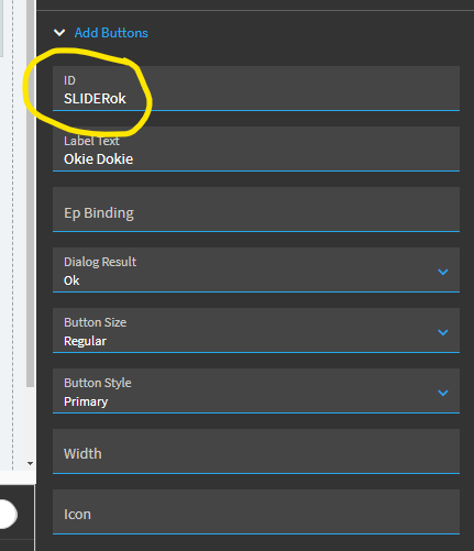

Copy the ID of the “Ok” button on your slider page.

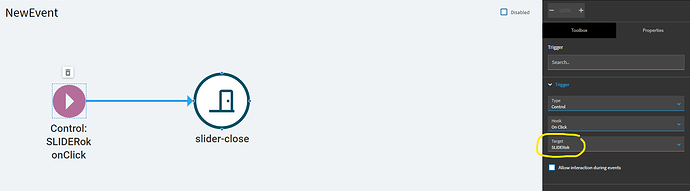

Try creating a new event:
Trigger:
Control > On Click > the name of your button ID on your slider page.
(it may not be in the dropdown options… just paste it in.
Then add a slider-close.
