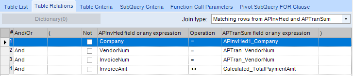

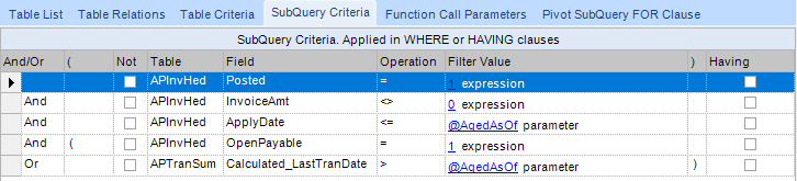

I was able to make the BAQ match the Aged Payables report by using the APTran table in a subquery with max(APTran.TranDate) to filter the top level query and get a total payment amount.
However, I needed to use the calculation below in a calculated field for the Total Payment Amount to get the correct balance when using a AgedAsOf date in the past. Then I set a relationship of APInvHed.InvoiceAmt <> TotalPaymentAmount field in the top level query.
(sum(
 case
     when APTran.TranAmt is null then 0
     when APTran.TranDate > @AgedAsOf then 0
     else APTran.TranAmt
 end
 )) as [Calculated_TotalPaymentAmt]
