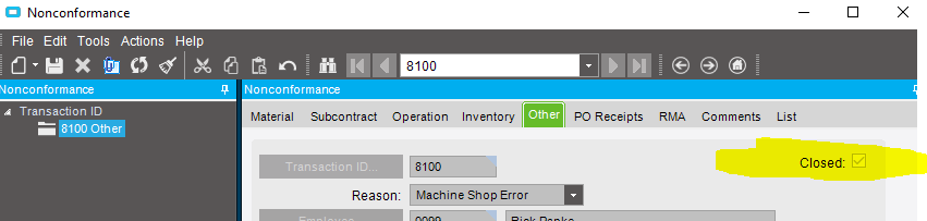

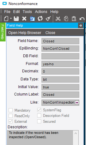

How can I pull the closed check box in a BAQ. I do not see any DB binding.
I think i was able to figure it out. The Inspection pending field determines open or closed.
Inspection Pending = True = Open
Inspection Pending = False = Closed
Correct me if I am wrong
Yes that is correct.
Non conformance is closed after you do inspection.
