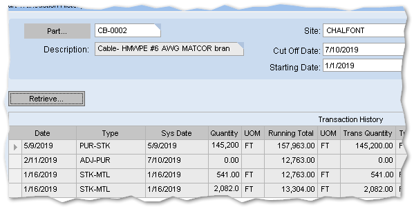

I created a zero dollar AP invoice against an outstanding “Rcv’d, Not Invc’d”, using a “Receipt Line”. That made a ADJ-PUR tran, but had a tran date that I don’t know where it came from.
  • The PO date was 1/24
  • Due Date:2/8
  • PO Rcpt entered on 5/9 (with 5/9 rcv’d date)
  • Zero dollar AP Invoice entered on 7/10.
Running WIP Recon (using sysdate of 7/1 - 7/31), shows the ADJ-PUR dated 2/11.
The Part Tran History confirms this
Where did that 2/11 date come from?
And even more important, does this change the cost? We use AVG costing and it looks like it does.
