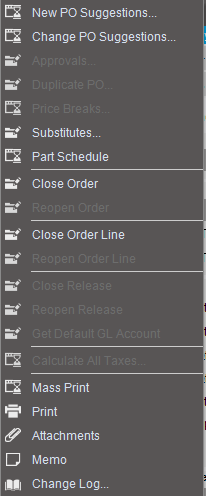

Thanks for coming back to me. This is the menu that pops up if we click on actions. As you can see the options for release are all greyed out. I was expecting to be able to close the individual releases as you can on a sales order, without having to close the line.
Having raised this with support, their response was to highlight a setting where PO releases are set to close at receipt. Without the receipt they apparently won’t close. They advised us to create an updateable BAQ to assist in this, but to me that is a solution that doesn’t actually answer the underlying question
