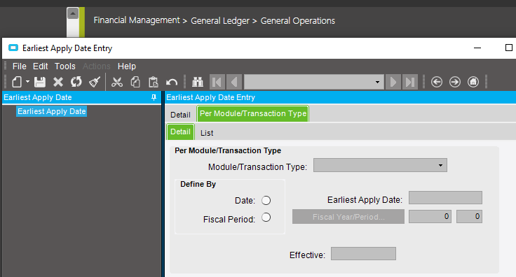

Try the Earliest Apply Date Entry per module
@rjenkins As posted by @prash172, please use Earliest Apply Date to block the transactions. AP Module is linked to Purchase Order Receipt Entry. Similarly, AR Module is linked to Customer Shipment Entry. In case, if you process AP Invoices but only block PO Receipt, I could suggest creating a BPM to block PO Receipt transactions into the prior period.
Thank you that works perfectly for stopping the postings.
Hello, how do you add more modules to the EAD entry?
