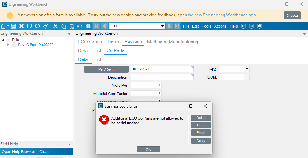

I am using CoParts to deal with purchasing in a kit.
I got the basics set up, but wondering if I can bypass the Business Logic and add serial tracking parts to CoParts?

How do I add the Parts to CoParts to begin with?
I manage to do CoParts without PNs that are Serial Tracked.

You are saying that when you set up the parts individually in Part maintenance, you were able to make them serial tracked but the first part (the one you are using for the main co-part) you were not able to set it up as serial tracked, correct?
Yes, but the opposite!
I set them as serial tracked on Part Maintenance, but I cannot add these serial tracked parts as a co part.
Epicor for some reason gave me a business logic error when I add serial tracked PNs to Co Part.
Sorry, I was thinking about lot tracked parts.
Serial tracked parts cannot be co-parts.
All good! is there anyway to bypass that? or is it a “it cannot be done, period” kinda thing?
