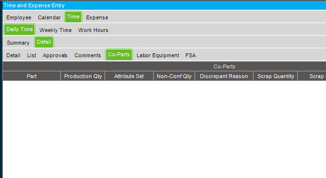

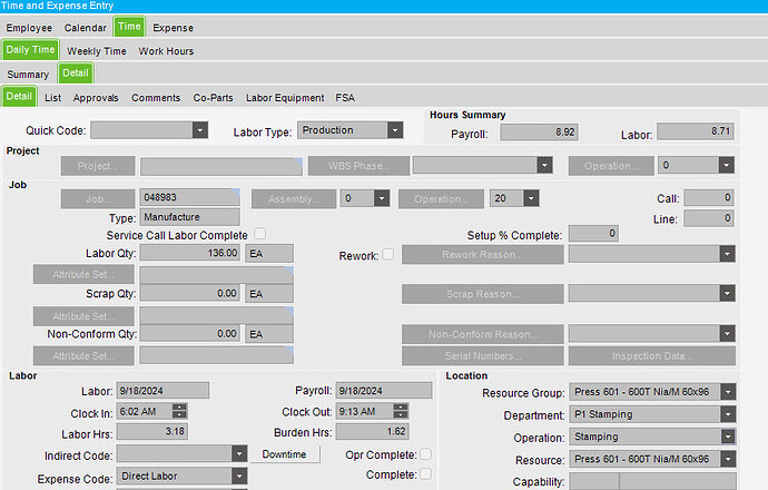

Good morning Utah,
Here are the two screenshots:
  1. The first shows the Qty claimed by the operator (not within the Co-Parts tab on MES). My expectation at this point is for me to “recall” the entry and proceed to next step,
  2. The 2nd screenshot is of same clock in, on the Co-parts tab, where I would expect to see both parts listed so I can split the quantity.

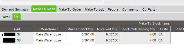

  3. I am also including a screenshot of the Demand link on the job, showing both parts listed.
I have tried multiple employees, clicking within the white empty space to try and “pull in” the Co-parts, and cannot get it to work. If there is anything else I can provide, please let me know.

I don’t know whether it is the same in Kinetic, but in Ep10 my understanding is that you don’t report separate quantities at each Op; you report the sum of parts. You only report separate quantities at the final Op.
Michelle, I’m pretty sure they should be using the co-parts tab in MES if this job has co-parts.
Are you saying that in this case they did not use it, but you are expecting to be able to split it after the fact?
