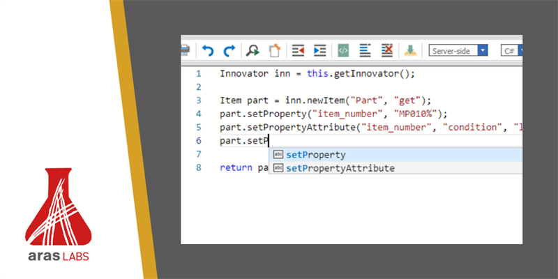

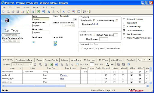

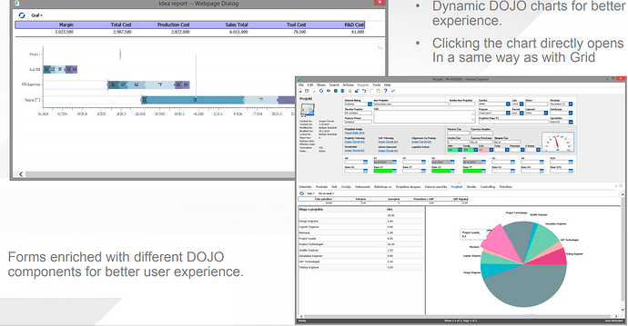

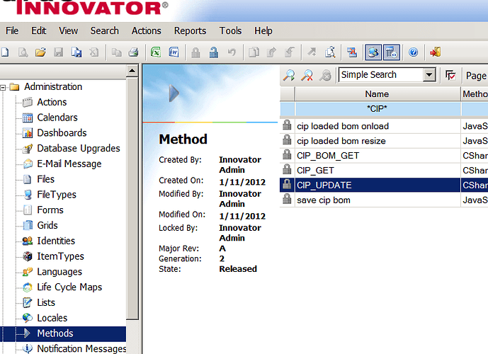

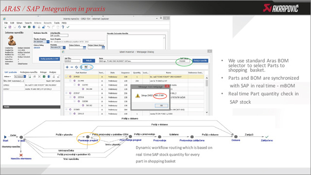

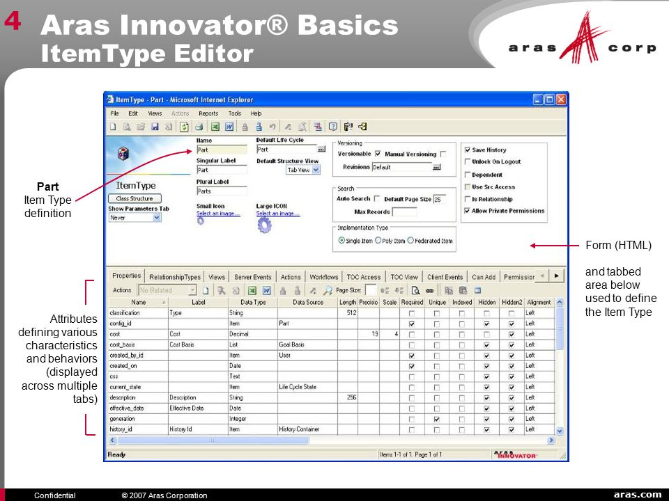

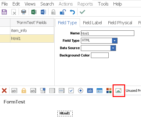

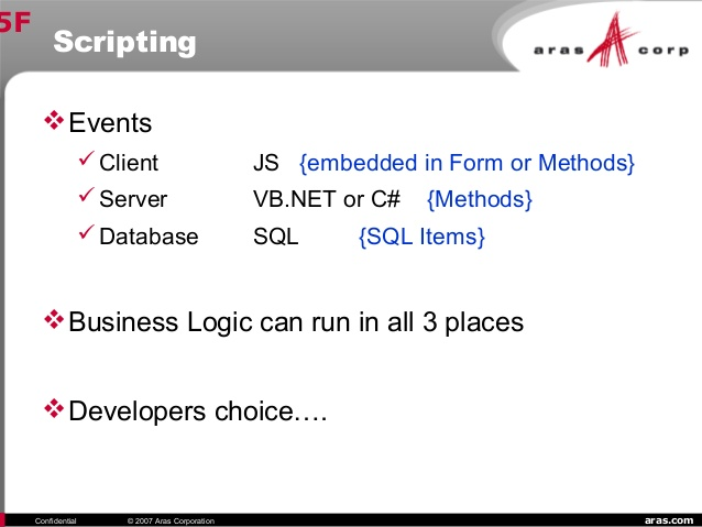

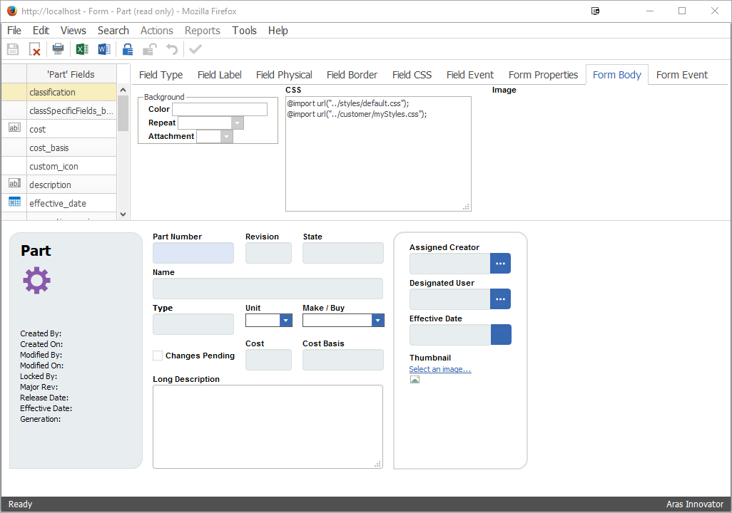

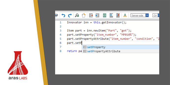

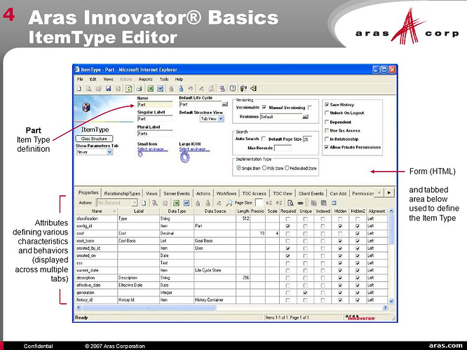

I think looking at open source www.aras.com they figured out alot of it for the most part. You can do Client Side JavaScript, HTML etc… Server Side C#. You create drop down types, field events, row events, etc… You can even debug the C# in browser and also Connect your code to VS… Their UI is a bit clunky but I think alot can be learned from their way of doing things (prob better ways now, but still it plants a seed).
