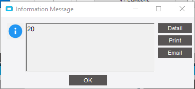

@NateS, I do not believe the error is because of a null value, instead it is because it thinks there is a property that could be set as a null. At least that is my interpretation. I am able to get the maxOp to show in a message, which is how I know that it is pulling the current op being added. I need to figure out how to get the op prior.
