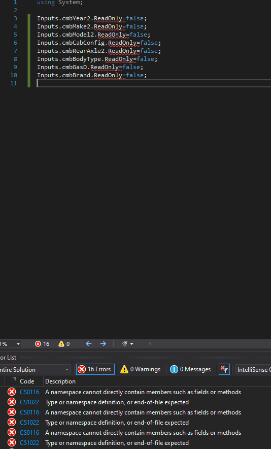

I am having a similar problem. I need users to be able to change a choice they’ve made. As things stand, you have to close out the Cinfig, and start again. Our EPICOR guy gave me this code:
Inputs.cmbYear2.ReadOnly=false;
Inputs.cmbMake2.ReadOnly=false;
Inputs.cmbModel2.ReadOnly=false;
Inputs.cmbCabConfig.ReadOnly=false;
Inputs.cmbRearAxle2.ReadOnly=false;
Inputs.cmbBodyType.ReadOnly=false;
Inputs.cmbGasD.ReadOnly=false;
Inputs.cmbBrand.ReadOnly=false;
The problem is that when I drop it in, each line bombs out because of the “ReadOnly”. So of course I went to the Inputs to see what my choices were![image|643x500]
…and nothing here would give the the desire result.(upload://mqNAIwoFsOHCUE973rHI8bythwT.png)

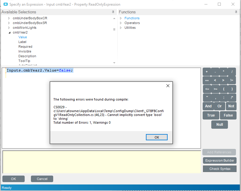

I went a step farther and dropped it into Visual Studio, and got this:

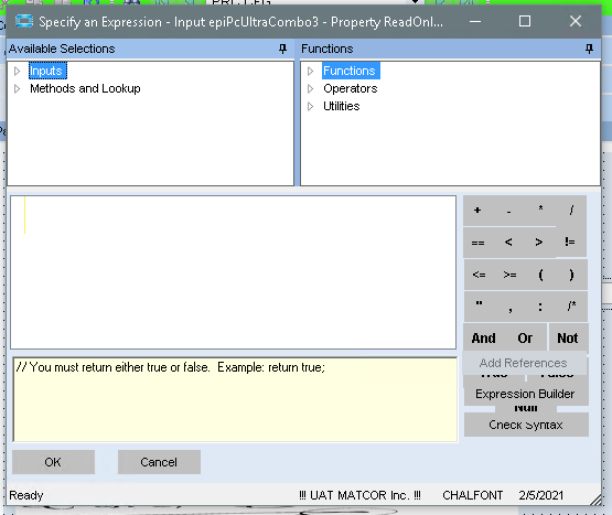

Let me back up a second … the ReadOnly property expects an expression. So you wouldn’t assign it a value like true or false, but rather an expression that returns true or false.
EDIT
You can’t assign the ReadOnly property outside of the control itself.

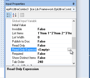

You need to select the control, then bring up the expression editor for the ReadOnly Property
Then enter your logic for when that control needs to be read only or not.

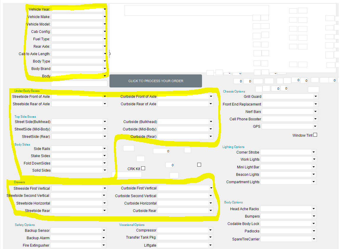

I already have the in the OnField for each input, my goal WAS to make it refresh each time a change is made. This is a Config to build trucks. If a sales person accidentally selects the wrong CA(Cab to Axle length) when they go to correct it, I need everything after it to refresh or the remaining choices won’t apply.
Inside of the yellow box is the main “keys”, I have the first 5 inputs Concant’ed into Key1, but I needed the ReadOnly Expression on everything down to the “Brand”.
This lets you control the fields that are getting updated so that if the change to CA doesn’t affect some fields they don’t get updated.
If it is in the read only then even when they are selecting something like Fire Extinguisher it will go and try to refresh all the dynamic lists.
Using a car/trunk type example if you have three combo boxes of Make, Model, and Engine size, when you select the model you would want the engine size combo box refreshed but not the Make. Refreshing the make would just be code that has (small) potential to cause issues because you don’t want the configurator to take forever to run and you don’t want it to refresh selections that don’t need it.
